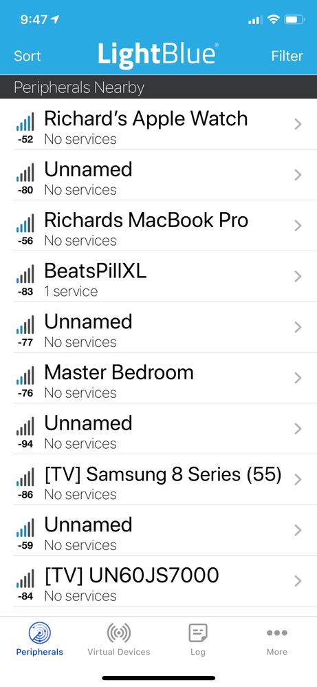

Hi am using the BlueNRG-LP. I am a master/client and want to discover local devices and then decide who to connect to ... I am able to get the advertising data from local devices including the BT addr, RSSI etc. But I want to get the Scan response data from them so I can get more information - such as name etc... So think along the lines of LightBlue or similar BLE Apps that get as much info as possible without needing to connect.
How is this achieved in this stack - the documentation is very thin!

Thanks Winfred. I have done as requested but I am definitely not seeing all the same information as I get with an app such as LightBlue or nRFConnect. On the apps I see device names and service information (before they even connect). I also do not get an event type of 0x1B.
I also note that the code in BLE_SensorDemo_Central uses an abstraction layer such as Master_Init() which I am unable to see, we dont get source code. Should I drop all that and just use the ACI commands instead?
I get the following
****Master_DeviceScanConfiguration() OK
ADDR 1 = be:20:15:e2:88:04:: RSSI : -85, Type 13- [02][01][06][11][07]g[9a][0c] [00][08][e2][a5][e3][11][[a6] [b3][e3][d9][02][0a][f8][06][ff][00][cc][10][ab][84]

In lightblue i see.... the attached image
Can you explain why I am getting nothing like this?
