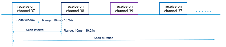

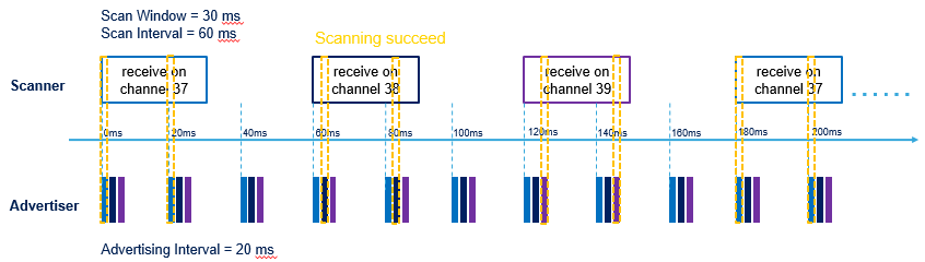

Hi Uiter,
HCI_LE_Set_Scan_Parameters() is used to set scan parameters including scan interval and scan window. Both have range between 10 ms and 10.24 s.
There is no right way, with longer scan windows the scanner shall scan more advertisers, but it consumes more power as well.
Below please reference the diagrams that i created. The timing is not very precise, but just to help you get the ideas.

Hi Uiter,
