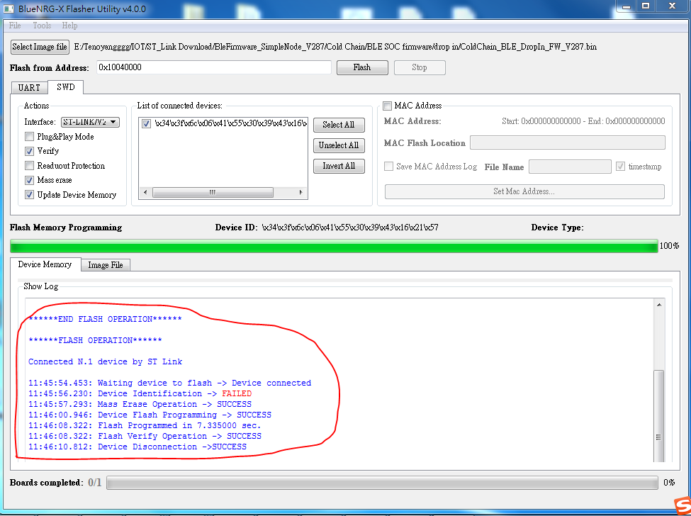

Dear ALL,
I can use BlueNRG-X_Flasher_GUI.exe to program the target chip,please see attached picture 1
But I want to use BlueNRG-X_Flasher_Launcher.exe to download, but I can’t do it. Here
is my attempt to follow the Commands.
Below is the command I tried:
C:\Users\TenoYang>BlueNRG-X_Flasher_Launcher.exe flash -SWD -all -f "C:\STLink.b
in"

RESULTS OF FLASH OPERATION ***
1 -
Device connected with STLink A (\x34\x3f\x6c\x06\x41\x55\x30\x39\x43\x16\x21
\x57)
Device =
None
Command
-> FLASH = Fail
WARNING
MESSAGE:
Device to
flash not connected.
Q:How to use BlueNRG-X_Flasher_Launcher.exe to download a bin file to the target chip
(BlueNRG-LP QFN48)???
Why doesit prompt that the device cannot be connected? Is my commands not correct?
could you give me some advice.
Looking forward to your reply, thank you very much!!
