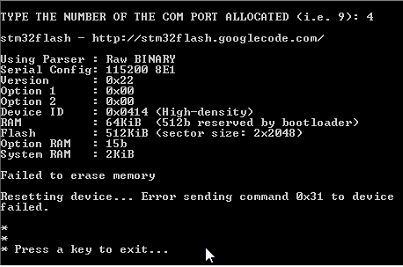

Good morning,
  I have some problems regarding firmware update. When  I try to update firmware via serial link, I obtain this message:
''Error sending message 0x31 to device'' as show also in the image:
Someone can help me?
Stefano

Ciao Stefano,
seems FLASH is corrupted...
Can you please try an update through standard (GUI-based) FlashLoaderDemonstrator tool?

Thank you for reply, Gerardo.
With ''flash demonstrator'' the issue is resolved. I can reprogram one module (I have two of this, one return unknown device) , performing the entire flash download. At the end the progress bar show in green. After that I release the BOOT0 pin and repower the module, but this doesn't write on the serial. Why?

Posted on March 30, 2016 at 13:24
Because you erased the bootloader too.
Starting address of application is 0x08002800.
Please contact your local distributor to recover that module.

It isn't possible to have bootloader binaries to flash on the board?

Please ignore last post, my distributor sended me the boot binaries.
