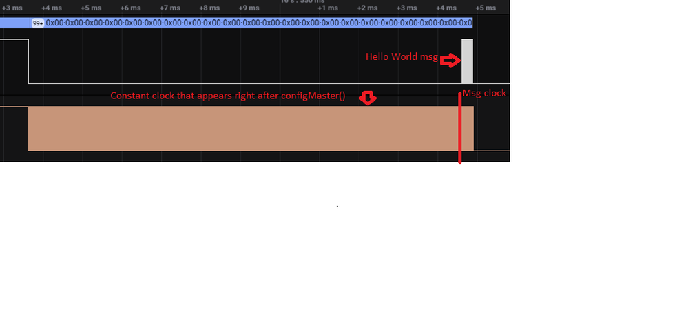

I am trying to make two STM32F4 with HAL communicate through SPI Simplex mode by changing who is the master node when it's ready to send a message. Both of the platforms start as a slave and they change to master to send a message and then go back to slave.

Changing the SPI configuration using configMaster() after configSlave() without calling the receive routine HAL_SPI_Receive() works great. However, my problem comes if I add the receive routine in between.
If I add the HAL_SPI_Receive() in between the configurations when I change the node to master the node will then start sending a constant clock through the CLK pin and bring low the DATA pin until I send the Hello World message. So why could this be happening? Is it a deinitialization problem?
I made sure to deinitialize the SPI peripheral before reconfiguring to each mode and went through the debug mode to check that the SPI register was 0 during deinitialization. Similarly, I made sure to reset to 0 every time the global SPI handler so it would not keep some config from the other mode.
0693W000008zf4NQAQ.pngFor reference, these are my configMaster() and configSlave() routines:

Also the exact point where the master starts sending the clock happens here: HAL_SPI_Init()
 /*----------------------- SPIx CR1 & CR2 Configuration ---------------------*/
  /* Configure : SPI Mode, Communication Mode, Data size, Clock polarity and phase, NSS management,
  Communication speed, First bit and CRC calculation state */
  WRITE_REG(hspi->Instance->CR1, (hspi->Init.Mode | hspi->Init.Direction | hspi->Init.DataSize |
                                  hspi->Init.CLKPolarity | hspi->Init.CLKPhase | (hspi->Init.NSS & SPI_CR1_SSM) |
                                  hspi->Init.BaudRatePrescaler | hspi->Init.FirstBit  | hspi->Init.CRCCalculation));
Any suggestion is welcomed. Thanks
