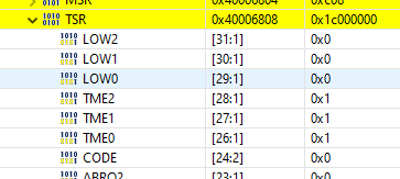

I would like to put the CAN2 interface into operation on a NUCLEO STM32F466RE board. For this purpose I have programmed an example in which a BYTE array HELLO is to be sent in the loopback.
If I now pass the TxHeader Struct to the HAL_CAN_AddTxMessage() method, this method is executed without error. The signal recording on the TX pin also shows a data transmission. It's just not the data I expected.
My data from the TxHeader cannot be entered in the mailbox register. It looks like the registers are locked, although all mailboxes report that they are free.
What else can I do wrong at this point?
What else could be the reason that the mailbox cannot be written to?

Try to enable also RCC CAN1 clock even using CAN2 only and see what happen.

And the Transmit Mailbox Bits indicate that there is no transmit request pending

When I look at the answer in the debugger, all three mailboxes are free.
Details:3
Default:3
Decimal:3
Hex:0x3
Binary:11

Now I have done the whole CAN initialisation on CAN1. On CAN1 my test software runs immediately. I can see in the debugger how the mailboxes are written with my data and the data I expect is transmitted.
Now I am asking myself why it works on CAN1 and not on CAN2.
MZimm.3
Hello all,
that was the important tip. Now it works on both CAN interfaces. Document RM0390 also says that CAN2 is only a slave and has no direct access to the SRAM. That was probably the reason why I could not write to the mailboxes.
Many thanks to all for your time and effort.
