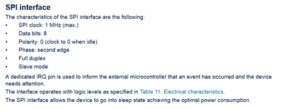

I found out what I was doing wrong, my pin connected to the bluenrg interrupt is PA3 and it works if I connect it to the IRQ3 interrupt, I instead connected it to IRQ1...now it still doesn't work because in "hci_notify_asynch_evt" the packet I receive has data_len  equal to 0...:frowning_face:
can you check if you call hci_tl_lowlevel_isr();
if yes, check the CS pin for SPI
yes, hci_tl_lowlevel_isr is called...and consequently HCI_TL_SPI_Receive is called, but, after
BSP_SPI1_SendRecv(header_master, header_slave, HEADER_SIZE);
      header_slave=[1,0,0,1,x81] so header_slave[0] is not 2

my spi is configured as the following:
hspi->Instance = SPI1;
hspi->Init.Mode = SPI_MODE_MASTER;
hspi->Init.Direction = SPI_DIRECTION_2LINES;
hspi->Init.DataSize = SPI_DATASIZE_8BIT;
hspi->Init.CLKPolarity = SPI_POLARITY_LOW;
hspi->Init.CLKPhase = SPI_PHASE_2EDGE;
hspi->Init.NSS = SPI_NSS_SOFT;
hspi->Init.BaudRatePrescaler = SPI_BAUDRATEPRESCALER_64;
hspi->Init.FirstBit = SPI_FIRSTBIT_MSB;
hspi->Init.TIMode = SPI_TIMODE_DISABLE;
hspi->Init.CRCCalculation = SPI_CRCCALCULATION_DISABLE;
hspi->Init.CRCPolynomial = 7;
hspi->Init.CRCLength = SPI_CRC_LENGTH_DATASIZE;
hspi->Init.NSSPMode = SPI_NSS_PULSE_DISABLE;
my clock is 160 MHz, so I use a prescaler of 64...I tried also a polarity of SPI_POLARITY_HIGH, but header_slave[0] is not 2...I have only 1 SPI.
malarab
Senior II
the max SPI clock supported by the BlueNRG is 1MHz
in your case the clock is too high ! (160/64 = 2.5MHz)
malarab
Senior II
check the config on the datasheet
could you send me a link to this datasheet?...thank you.
