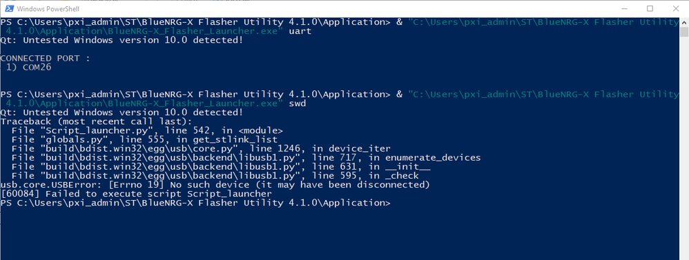

BlueNRG-X Flasher Utility (4.1.0) is not recognizing SWD connections when ST-link/V2 is connected. I'm running the flasher through a command line interface to get the error message (BlueNRG-X_Flasher_Launcher.exe).
VLima.1
The error message that appears is:
"Traceback (most recent call last):
File "Script_launcher.py", line 542, in <module>
File "globals.py", line 555, in get_stlink_list
File "build\bdist.win32\egg\usb\core.py", line 1246, in device_iter
File "build\bdist.win32\egg\usb\backend\libusb1.py", line 717, in enumerate_devices
File "build\bdist.win32\egg\usb\backend\libusb1.py", line 631, in __init__
File "build\bdist.win32\egg\usb\backend\libusb1.py", line 595, in _check
usb.core.USBError: [Errno 19] No such device (it may have been disconnected)
[47128] Failed to execute script Script_launcher"

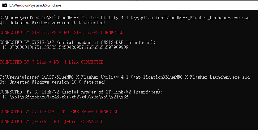

Were you using STEVAL-IDB011V1 ?
By default CMSIS-DAP can be used without needing an external ST-Link/V2.
Anyway, both shall work:

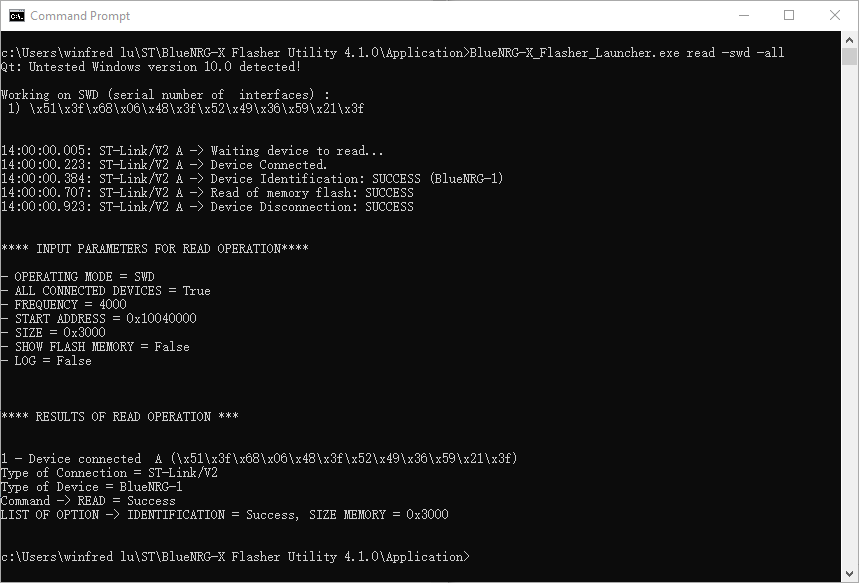

Looking back to your screenshot, the traceback shows that pyusb/libusb failed when iterating on all the enumerated (ST-Link) devices. It was somehow disconnected?
I am not able the replicate the issue with my laptop and ST-Link/V2.
