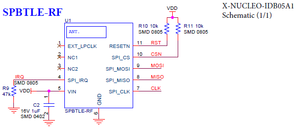

Posted on March 28, 2018 at 12:46
Thank you for answer.
I use SPBTLE-RF on own PCB. STM32L4A6 connect via SPI with SPBTLE-RF.
After exhange the headers IRQ must reset (in
BlueNRG_SPI_Read_All)
. But IRQ line is not 0.
STM32L4 gets normal slave header: 0x2 0x7F 0x00 0x06 0x00.
Posted on March 28, 2018 at 15:17
Do you have a pull-down resistor on the IRQ pin of your custom PCB?
In the
http://www.st.com/content/st_com/en/products/ecosystems/stm32-open-development-environment/stm32-nucleo-expansion-boards/stm32-ode-connect-hw/x-nucleo-idb05a1.html
board, based on the same SPBTLE-RF module, there is a 47k resistor, as you can see below.0690X0000060AIEQA2.png

Posted on March 28, 2018 at 16:11
I use inner pull-down resistor in STM32L4.
Posted on March 29, 2018 at 10:53
Hi Aleksey,
the inner pull-down could be fine, but I've never tested this configuration. In all the boards that I am using, there is an external resistor.
If you can find a
NUCLEO-L476RG and an X-NUCLEO-IDB05A1 board, you will have a working reference that should make it easier for you to check what is going on in your custom board.
