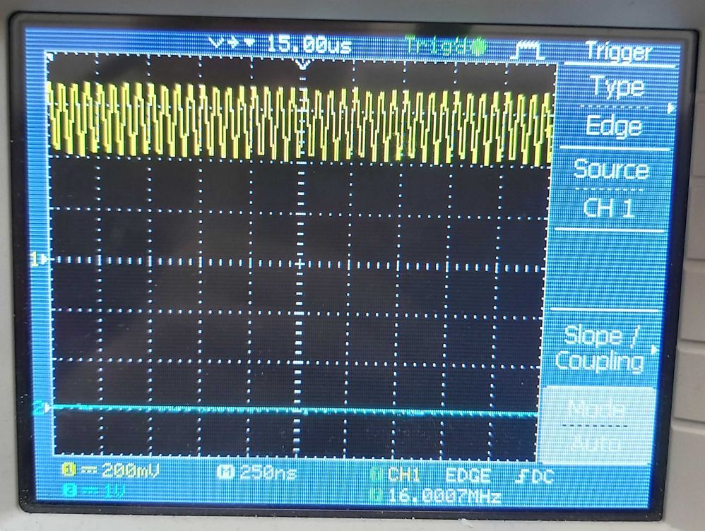

The 1V8 and 1V2 are OK and the 16MHz clock is ticking at 16MHz correctly.

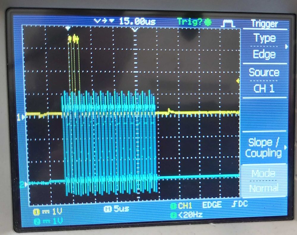

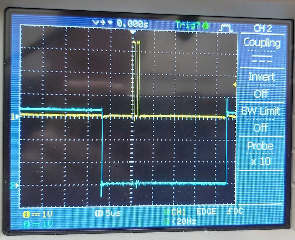

I can see the trame {0x0a, 0x00, 0x00, 0x00, 0x00} on the oscilloscope on MOSI and there is nothing on MISO. Which indicate that the SPI is not ready, then the function return a Timeout.
0693W000008GPvQQAW.jpgFigure 1. SPI_MOSI and SPI_CLK during (BSP_SPI4_SendRecv(header_master, header_slave, HEADER_SIZE);)
0693W000008GPw9QAG.jpgFigure 2. SPI_MOSI and SPI_CS during (BSP_SPI4_SendRecv(header_master, header_slave, HEADER_SIZE);)
0693W000008GPwOQAW.jpgFigure 3. XTAL2 after SPI_RESET goes HIGH.
According to the Test document, if there is no signal on IRQ after a reset, it means that the BlueNRG firmware is not running.

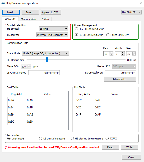

      • IFR has to be configured accordingly (to use RO instead)
      • ifr_3v1_003_mode02-16MHz-RO32K_4M.dat (prebuilt) shall be used, located in C:\Program Files (x86)\STMicroelectronics\BlueNRG GUI 3.2.1\Firmware\BlueNRG-MS_stack\

    Thank you for the reply.
    I have checked yesterday this IFR configuration. I found this file "ifr_3v1_003_mode02-32MHz-RO32K_SMPS_OFF.dat" under the folder : "BlueNRG DK 2.0.2\Firmware\BlueNRG-MS_stack\SMPS_OFF" which correspond to my design.
    I've copied the last 192Bytes which correspond to the IFR section of the µC and pasted them in bluenrg_IFR.c like this:

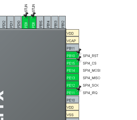

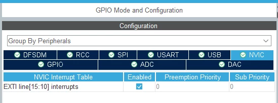

    Maybe it has something to do with the pins I use: 0693W000008Ga1YQAS.pngIf you have any guesses =)

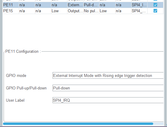

    EDIT: I found the interruption by implementing this function:
    void EXTI15_10_IRQHandler(void) {
    	while(1);
    I've checked and it means that the Callback function hci_tl_lowlevel_isr() is not called. So it doen't read the data. I hacked my way throught by doing this:
    	hci_tl_lowlevel_isr();
    I still need to investigate if everything is ok or not.

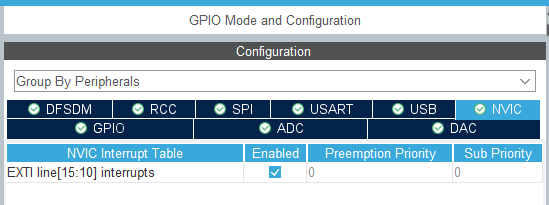

    When Default_Handler is called, it means the processor receives an interrupt but doesn't know to handle that interrupt. This is mostly because the interrupt (ISR etc) is not configured correctly.
    It seems that the configuration of EXTI line is missing from your implementation? Check HAL_EXTI_SetConfigLine()?

    Thank you for the answer.
    I Activated the EXTI lines Interrupts and verified that the interrupt was correctly configured. It seems to work.
