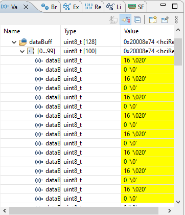

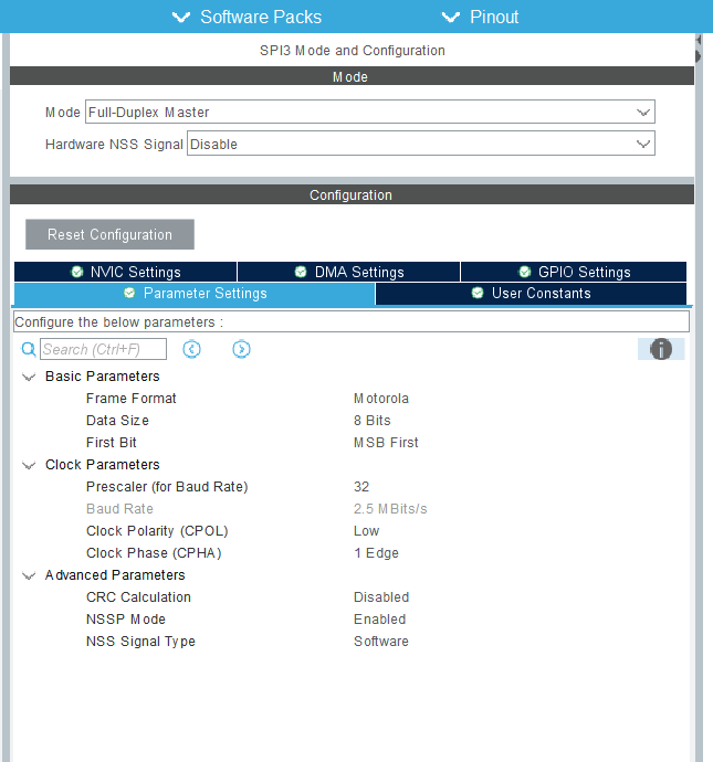

Hello,I am trying to initialize my blueNRG-2N but I am not getting the expected values after a hardware reset.
I should get through datashet: [02,7F,00,00,00], [02,7F,00,06,00], and [04, FF, 03, 01, 00, 01].
The picture below shows the values I get.
Do you have any suggestions?
Thank you.
I had also tried the proposed solution, but the problem remained the same until I made these adjustments.
