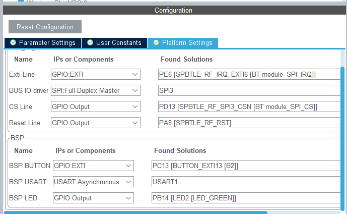

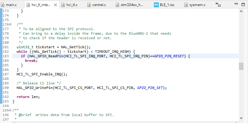

It is stuck in here for BlueNRG-2.0693W00000UFOkDQAX.pngBlueNRG-2 configuration I made like this.

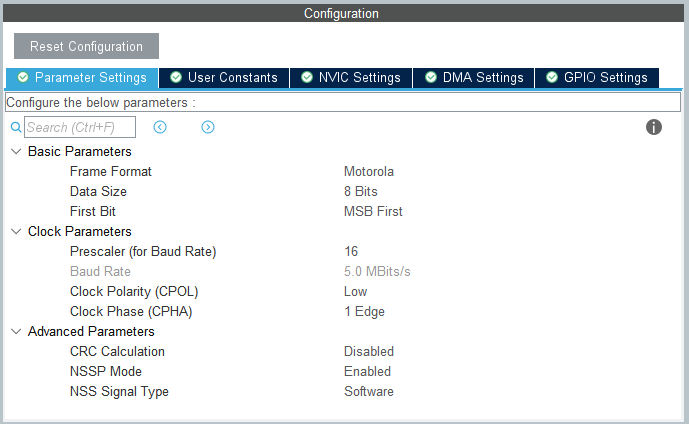

0693W00000UFOkNQAX.pngSPI configuration

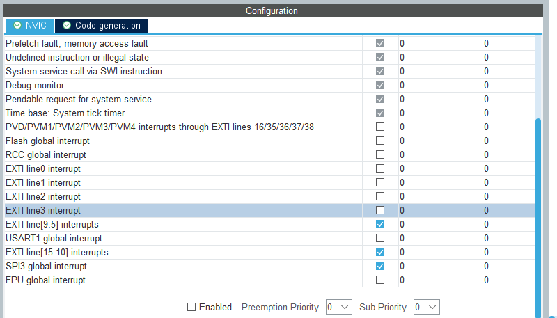

0693W00000UFOkcQAH.pngNVIC configuration 0693W00000UFOmsQAH.pngCould you guys please check it. Where is the problem?

MOhamed_Mehery
I beleive that the interrupt is inactive at this line, the HAL_Get_tick function return the value of systick timer, if the interrupt is disabled, the timer value won't be changed
