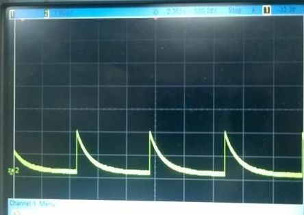

I've designed BTLE board with BlueNRG and STM32L152. After resetting BlueNRG, voltage at pin12 (VDD1V8) is not stable. It is observed that after every around 1.5 seconds BlueNRG SMPS turns on for a while and goes off.
Can anybody explain what is the cause of this problem? Waveform at 1.8V pin is below for reference

Hi Jitendra
I think you'll find this is correct operation. The Bluetooth radio is waking every 1.5s to receive/transmit, then going back to sleep. While asleep the power rails are not required and the DC-DC converter switches off.

as Charles has said, this is a normal behaviour of BlueNRG device.
