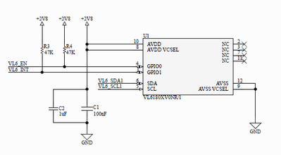

Hi there,
My team and I have noticed an irregularity in our VL6180X sensor data that we do not understand. Despite having a stationary target (~75mm away), the calculated range values from the VL6 appear to "wave" over time, and do not settle into a steady state (see screenshots). When running as expected, the sensor typically reads a consistent range value with a variance of +/-3.5mm between readings. Please note that we have eliminated all sources of cross talk as well and are conducting our experiments in a closed, dark tube that is not exposed to direct light. What could be the issue here? Is this normal behaviour for the sensor?

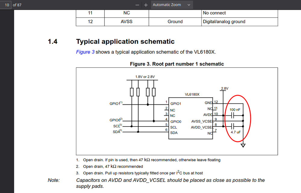

Have capacitors on AVDD and AVDD_VCSEL been placed? How is the PCB layout?
The datasheet recommends: "Capacitors on AVDD and AVDD_VCSEL should be placed as close as possible to the supply pads" which could be an indication that it doesn't have good noise immunity for the power supply.
Kurt-123
Hi RhSilicon, thank you for your reply!
Yes, we do have capacitors, but it looks like the Farad ratings are slightly lower than the recommended spec. Do you think that the difference is large enough to have an impact on noise stability? Our capacitors are less than 2mm away from the supply pads, too.
In these cases it is recommended to use low ESR capacitors. How is the layout?
- (From the schematic it is possible to notice that the importance of the decoupling informed in the datasheet may not have been observed, the capacitors are close together and far from the pins)
And about the power supply circuit, are you using a switched or linear regulator?

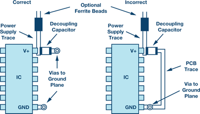

About layout, here are some tips:
Low frequency noise decoupling generally requires electrolytic capacitors (typically 1 μF to 100 μF) that act as charge reservoirs to low frequency transient currents. High frequency power supply noise is best reduced with low inductance, surface-mount ceramic capacitors connected directly to the power supply pins of the IC (typically 0.01 μF to 0.1 μF). All decoupling capacitors must connect directly to a low impedance ground plane in order to be effective. Short traces or vias are required for this connection to minimize additional series inductance.
5104-fig3
See full text here: https://www.analog.com/en/analog-dialogue/studentzone/studentzone-april-2017.html
