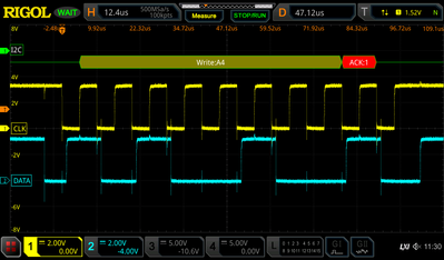

I'm trying to get the VL53L5CX-SATEL to talk to a microcontroller.
The lines are connected as follows
| INT | Floating |
| I2C_RST | 22K pull down |
| SDA | MCU SDA Pin with 2.2K pull up to 3.3v |
| SCL | MCU SCL Pin with 2.2K pull up to 3.3v |
| LPn | 22K pull up to IOVDD (3.3V) |
| PWREN | 22K pull up to AVDD (5V) |
| AVDD | 5V |
| IOVDD | 3.3V |
| GND | GND |
When I try to send a write command, the device does not ACK the address (0x52). Can anyone see what I'm doing wrong?
Solved! Go to Solution.
2023-10-09 5:04 AM - edited 2023-10-09 5:04 AM
OK, the I2C driver in the MCU was shifting the address left by 1 so the address was being sent as 0xA4 as seen in the trace. With the address corrected it works. Thanks all.
