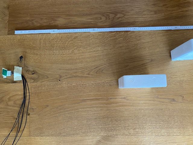

This is my test setup:
The output looks like that:
571 0 0 0
584 0 0 0
575 0 0 0
581 0 0 0
578 0 0 0
Which clearly isn't correct.
1. There is only one object detected. 2. The distance isn't even correct for one of the objects that are ~50cm and 76cm away from the sensor.
Furthermore i am expecting that it continuously getting data but sometimes it is stuck and then after ~10sec it continues getting data...

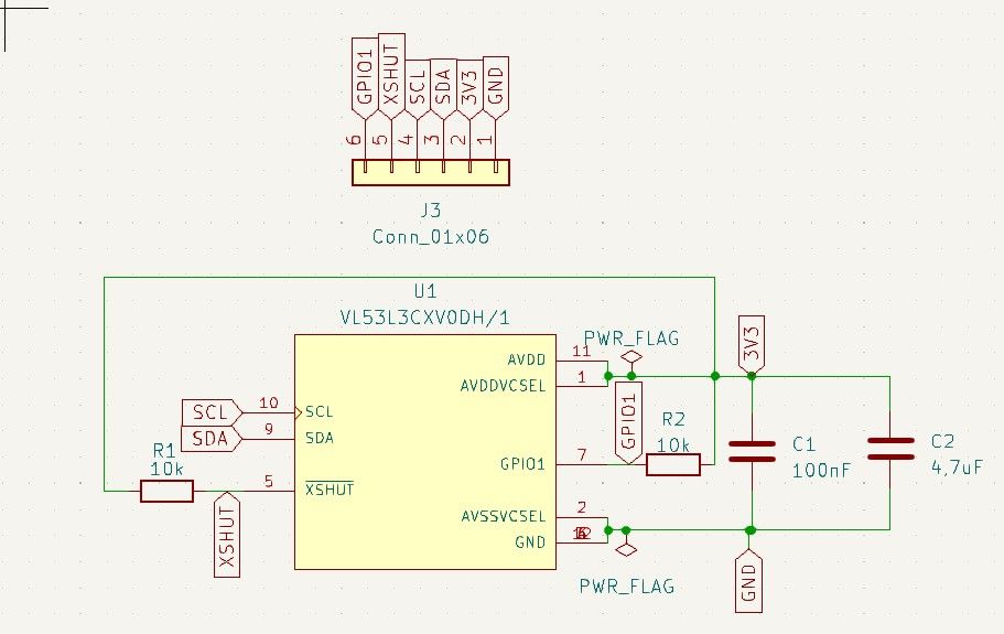

My schematic of the PCB looks like that:
Has anybody an idea what i am doing wrong??
Thanks for your help!

Try this bit of code - it's for the L1, but the two processors are neary the same, and you can easily change the VL53L1 to VL53L3 and run it.
If you set the sensor to running, you can query the sensor every bunch of milliseconds and you should see data.
But do print out the range_status. When something goes wrong that status tells you what the issue is.
- john

PHumm.2
Hi John,
thanks for your reply. It seems like the command works:
Starting...
GetVersion: rc=0, Build=4, Major=1, Minor=1, Revision=2352
GetProductRevision: rc=0, Major=1, Minor=1
GetDeviceInfo: rc=0, ModuleType(0xAA?)=0xAA, ProdRevMajor=1, ProdRevMinor=1
GetUID: rc=0, UID=0xFDEFC3745D1814C5
I2CRead 0x010F: rc=0, Model_ID=0xEA
I2CRead 0x0110: rc=0, Module_Type=0xAA
Ready...
I n my code i am now always printing the ranging status.
Here i moved my hand in and out of the FoV. Beause of cable length issues the sensor is looking into the far where no object is. The test looks good so far:
Ranging status: 255; Nothing found
Ranging status: 12; Nothing found
Ranging status: 0; Distances: 187 0 0 0
Ranging status: 0; Distances: 210 0 0 0
Ranging status: 0; Distances: 196 0 0 0
Ranging status: 0; Distances: 209 0 0 0
Ranging status: 0; Distances: 201 0 0 0
Ranging status: 0; Distances: 214 0 0 0
Ranging status: 0; Distances: 212 0 0 0
Ranging status: 0; Distances: 198 0 0 0
I tested your code and called "i2c_test(&vl53l3cx);" in the loop(). This is the output:
Ranging status: 4; Nothing found
[955197][E][Wire.cpp:499] requestFrom(): i2cWriteReadNonStop returned Error -1
[955200][E][Wire.cpp:499] requestFrom(): i2cWriteReadNonStop returned Error -1
[955207][E][Wire.cpp:499] requestFrom(): i2cWriteReadNonStop returned Error -1
[955214][E][Wire.cpp:499] requestFrom(): i2cWriteReadNonStop returned Error -1
[955221][E][Wire.cpp:499] requestFrom(): i2cWriteReadNonStop returned Error -1
[955227][E][Wire.cpp:499] requestFrom(): i2cWriteReadNonStop returned Error -1
[955234][E][Wire.cpp:499] requestFrom(): i2cWriteReadNonStop returned Error -1
expected   = eacc10ff,
read_multi =  0,  0, 20,  9
read_bytes =  0,  0,  0,  0
read words =    0,    0
read dword =        0
[955253][E][Wire.cpp:499] requestFrom(): i2cWriteReadNonStop returned Error -1
[955260][E][Wire.cpp:499] requestFrom(): i2cWriteReadNonStop returned Error -1
[955267][E][Wire.cpp:499] requestFrom(): i2cWriteReadNonStop returned Error -1
[955273][E][Wire.cpp:499] requestFrom(): i2cWriteReadNonStop returned Error -1
[955280][E][Wire.cpp:499] requestFrom(): i2cWriteReadNonStop returned Error -1
[955287][E][Wire.cpp:499] requestFrom(): i2cWriteReadNonStop returned Error -1
[955294][E][Wire.cpp:499] requestFrom(): i2cWriteReadNonStop returned Error -1
[955301][E][Wire.cpp:499] requestFrom(): i2cWriteReadNonStop returned Error -1
[955308][E][Wire.cpp:499] requestFrom(): i2cWriteReadNonStop returned Error -1
expected   = 11223344,
read_multi =  0,  0,  0,  0
read_bytes = 60, 67, c9, 3f
read words =    0,    0
read dword =        0
[955327][E][Wire.cpp:499] requestFrom(): i2cWriteReadNonStop returned Error -1
[955333][E][Wire.cpp:499] requestFrom(): i2cWriteReadNonStop returned Error -1
[955340][E][Wire.cpp:499] requestFrom(): i2cWriteReadNonStop returned Error -1
[955347][E][Wire.cpp:499] requestFrom(): i2cWriteReadNonStop returned Error -1
[955354][E][Wire.cpp:499] requestFrom(): i2cWriteReadNonStop returned Error -1
[955361][E][Wire.cpp:499] requestFrom(): i2cWriteReadNonStop returned Error -1
[955368][E][Wire.cpp:499] requestFrom(): i2cWriteReadNonStop returned Error -1
[955375][E][Wire.cpp:499] requestFrom(): i2cWriteReadNonStop returned Error -1
expected   = ffeeddcc,
read_multi = ff, ee, dd, cc
read words =    0,    0
read dword =        0
[955394][E][Wire.cpp:499] requestFrom(): i2cWriteReadNonStop returned Error -1
[955400][E][Wire.cpp:499] requestFrom(): i2cWriteReadNonStop returned Error -1
[955407][E][Wire.cpp:499] requestFrom(): i2cWriteReadNonStop returned Error -1
[955414][E][Wire.cpp:499] requestFrom(): i2cWriteReadNonStop returned Error -1
[955421][E][Wire.cpp:499] requestFrom(): i2cWriteReadNonStop returned Error -1
[955428][E][Wire.cpp:499] requestFrom(): i2cWriteReadNonStop returned Error -1
[955435][E][Wire.cpp:499] requestFrom(): i2cWriteReadNonStop returned Error -1
[955442][E][Wire.cpp:499] requestFrom(): i2cWriteReadNonStop returned Error -1
expected   = 55667788,
read_multi = ff, ee, 77, 88
read words =    0,    0
read dword =        0
[955461][E][Wire.cpp:499] requestFrom(): i2cWriteReadNonStop returned Error -1
[955467][E][Wire.cpp:499] requestFrom(): i2cWriteReadNonStop returned Error -1
[955474][E][Wire.cpp:499] requestFrom(): i2cWriteReadNonStop returned Error -1
[955481][E][Wire.cpp:499] requestFrom(): i2cWriteReadNonStop returned Error -1
[955488][E][Wire.cpp:499] requestFrom(): i2cWriteReadNonStop returned Error -1
[955495][E][Wire.cpp:499] requestFrom(): i2cWriteReadNonStop returned Error -1
[955502][E][Wire.cpp:499] requestFrom(): i2cWriteReadNonStop returned Error -1
[955509][E][Wire.cpp:499] requestFrom(): i2cWriteReadNonStop returned Error -1
read_multi = 44, ee, 77, 88
read words =    0,    0
read dword =        0
i2c test failed - please check it. Status = 1
I am pretty new to that esp32 and distance sensor thingy...can you work with this output?
Does it mean that there is a communication issue in the vl53l3cx?
