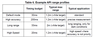

I am currently actively debugging and working with the sensor and it shows correct measurement data when i set the profile to 'Long range' example (settings from the 'um2039' User manual).
however the sensor response for RangeDMaxMilliMeter: always show a value around 1200 which should be around 2000, is there another settings which i need to do before the profile is actively set to long range?
Measurement data is now also correctly measured until about 1200mm but higher results in invalid measurements.
below are my settings as they are performed in the code:

 	// Configuration steps (!!!!!!!!!!!! Long range mode !!!!!!!)
 	// Limit check value >> 1
  VL53L0X_Error configuration_step = VL53L0X_SetLimitCheckValue(VL53L0X_DEV,
    VL53L0X_CHECKENABLE_SIGNAL_RATE_FINAL_RANGE,
    (FixPoint1616_t)(0.1 *65536));
  if (configuration_step != VL53L0X_ERROR_NONE)
   	// Some error
    g_tof_state = tof_sensor_reset_sensor;
    return HAL_ERROR;
 	// Limit check value >> 2
    VL53L0X_CHECKENABLE_SIGMA_FINAL_RANGE,
    (FixPoint1616_t)(60 *65536));
   	// Some error
    return HAL_ERROR;
 	// Measurement timing budget
  configuration_step = VL53L0X_SetMeasurementTimingBudgetMicroSeconds(    VL53L0X_DEV, 33000);
   	// Some error
    return HAL_ERROR;
 	// VCEL pulse period 1
  configuration_step = VL53L0X_SetVcselPulsePeriod(VL53L0X_DEV,
    VL53L0X_VCSEL_PERIOD_PRE_RANGE, 18);
   	// Some error
    return HAL_ERROR;
 	// VCEL pulse period 2
    VL53L0X_VCSEL_PERIOD_FINAL_RANGE, 14);
   	// Some error
    return HAL_ERROR;
 	// Device mode
  configuration_step = VL53L0X_SetDeviceMode(    VL53L0X_DEV, VL53L0X_DEVICEMODE_SINGLE_RANGING);
   	// Some error
    return HAL_ERROR;

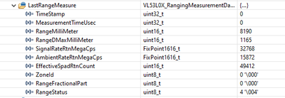

After throwing away the RangeDMaxMillimeter variable problem i am now left with the reason why my sensor does not measure beyond 1,2m. as soon as the measurement goes beyond 1,2m i get the following resulting measurement data:
Can anybody help me make sens of the values to check where the problem is (in software or surrounding noise etc).
The RangeMillimeter variable holds a value 8190 if i go beyond 1,2m from the sensor, before the 1,2m it holds an accurate value.

SLERO.1
hi, did you triy to read the register 0x14 who is Result interrupt status and decode it ?

John E KVAM
DMAX is a very mis-understood number.
It's a function of ambient light. It says, "Given the amount of ambient light seen, a target can only be detected up to this distance." Said another way, "I cannot see beyond DMAX due to conditions".
The sensor can 'see' to 2M in ideal conditions. Near a window, there could be enough sunlight to reduce that max distance to that Dmax range.
Cellphone companies wanted that number to start an autofocus search at DMAX. So even if the sensor saw no target, they could save a lot of time, not needing to autofocus at the short distances.
