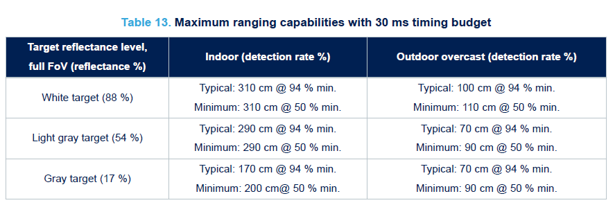

However our experimental results can not provide the quoted detection rate in the datasheet as below.

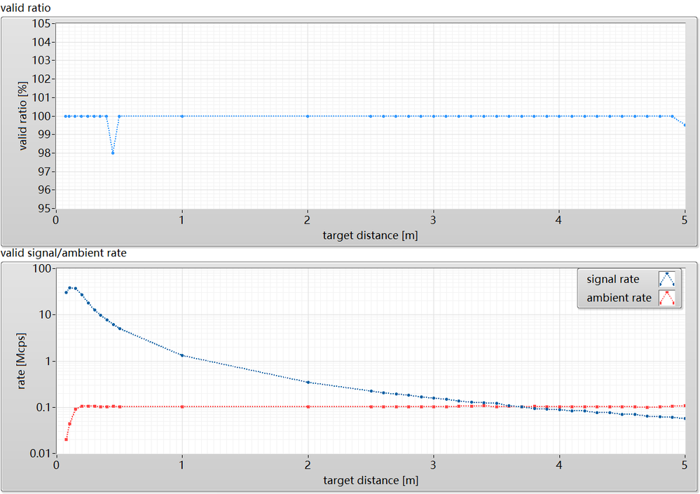

0693W00000GWsnKQAT.pngWe did our tests in a dark room environment (50Lux on average with normal fluorescent lamp), and set the white wall as the target. The width and height of the wall are both larger than 2.5m for our 5m range tests, which should make sure the "target" qualified. The distance between the evaluation board and the target is allocated from 70mm to 5000mm with different step length. And we recorded 200 report values provided by your software at each distance, including the RangeStatus, signal/ambient rate, etc. Thus a detection rate changing with target distance should be generated as plotted below, along with the mean signal/ambient rate.
0693W00000GWsr2QAD.pngThe ratio between 0-RangeStatus and total test number per each distance stays almost 100%! That's why I said the 50% and 94% detetction rate are hard for me to reproduce. Yes, your datasheet declares those two values are in the worst case. But an almost 100% detection rate at any given distance can not stop me having doubts on my experimental procedures.

Wow, that's some serious work.
LUX does not matter. Lux is a measure of visible light. And it does not include 940nm. However in sunlight, knowing the Lux level, one can guess at the 940nm using a graph of sunlight. (There is less 940nm in sunlight because a lot was absorbed by the water vapor. It's one reason to choose 940nm.)
If you didn't get our results in your lab, then your florescent tube is generating 940nm. And when you are pushing the limits, that bit of ambient makes a difference.
Switch to LED lighting and your ambient will go to 0.
Getting outside data is almost impossible. Not only is brightness an issue, but direction is too. You get different answers based on the direction the sun is to the sensor and the target. I couldn't even begin to design the experiment.

In fact, we are concerning that why a LOW detection rate result can not be acquired in our indoor lab. It's critical for us to reproduce the 94%, 50% and even lower values, not an always nearly 100% 0-RangeStatus.
As described above, within 5m range in the indoor lab, we got the detection rate values always near 100%, so we are confused the meaning of "typical: 310cm @94% min; minimum: 310cm @50% min" quoted from datasheet. If these rate values are overestimated, then why public such corresponding distances?
Is it possible for us to know under what experimental condition do you get the 50% and 94% values?
