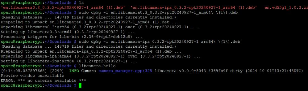

I am using a VD55G1 sensor with P-board to interface with Rpi 5. I am using Camera port #0 of Rpi. I downloaded the STSW-IMG506_V4L2, STSW-IMG506_LIPA and STSW-IMG506_LCAM. I followed the steps to install V4L2 driver from the "Linux Start Guide for ST BrightSense image sensors" document and updated the device tree to include pcb4189_vd55g1_cam0.dts, added the same to config.txt as well. I upgraded the system to support latest version of libcamera packahe and extracted both LIPA and LCAM .deb files, but rpicamera-hello or libcamera-hello doesn't detect camera. At the same time I found the libcamera version to get messed up upon extracting the LIPA and LCAM libraries (refer the attached image before and after installing the package).
Before extracting the LIPA and LCAM  library files
After extracting the LIPA and LCAM  library files
Debugging steps:
I did not find any external hardware from the /dev/ though I interfaced a FPC cable with P-board and promodule with VD55G1 sensor.
I tried updating device tree with pcb4280_vd55g1_cam0.dts, but still same behaviour.
I switched to camera #1 and tried pcb4280_vd55g1_cam1.dts and pcb4189_vd55g1_cam1.dts, but no changes.
I made sure the libraries are only compiled to arm64 versions and I did make sure I connected the camera the way it was described in ST's documents.
The Linux User guide document mentions to download libraries from st.com, but wanted to confirm if the drivers are updated from Rpi 5.

The procedure seems good. Indeed, our drivers have been updated to work on RPI 5.
To facilitate debugging, could you please reboot the board and share the log generated by the dmesg command? This will help us determine whether the issue originates from the DTS file or the driver.

I figured out the cable interpretation was different in the P-board datasheet (or maybe the cable I got had interpretation inverted) and I was also installing both the IPA and LIPA that was causing the library to get corrupted. I did a fresh install of drivers again with only IPA and validated the libcamera version to remain at v0.3.2 and further access the camera using rpicam-hello and libcamera tools.

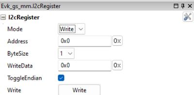

Furthermore, I would like to directly access CSI TX outputs (the Data_p, Data_n, and the corresponding clock signals) from the P-module for input into my CSI 2 Receiver block on FPGA. But I am confused on the configurations required to stream the data.
I found the "How to integrate and configure the VD55G1 sensor" manual describing the software states and process of going over them to reach the Streaming stage by modifying the "register values from UI". Does UI mean the register configurations from the I2C EVK GS software (as attached in the screenshot below)?.

UI stand for User Interface, which denotes a type of memory accessible to the host. So yes, it is the same registers that you can change with the EVK GS software and described in the user manual. The code examples that we use are ST internal notation. But you can use your platform's I2C commands along with the sensor's register addresses to interact with the sensor.

I used the software to configure the registers (do basic operations such as switching between Streaming and Standby, etc.) and it works fine.
