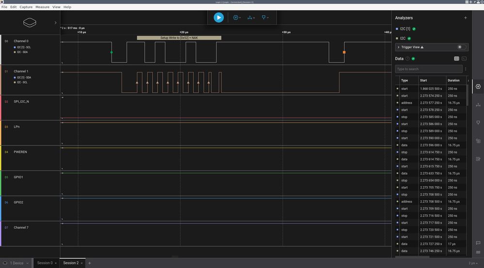

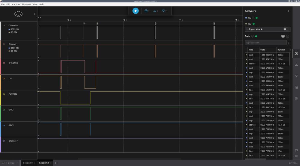

I am attempting to connect the satel-vl53l8a to the Nordic Semiconductor nRF5340 using the I2C protocol, but I am not receiving any acknowledgment (ACK). I have followed the wiring diagrams provided in this document: AN5945. Additionally, I have captured the output of my logic analyzer for reference.
Startup sequence and signal sent to VL53L8AStartup sequence and signal sent to VL53L8Athe i2c address is always NAKthe i2c address is always NAK

The sensor is pretty complicated, but the I2C is not. It needs power, ground, and an I2C. And you need to lift the LPn pin. I'm betting it the LPn pin. Essentially, this pin enables the I2C. That app note tells you to connect the pin, but does not provide much in the way of protocol.  It assumes you are using the ST provided software.

Ok, so I got the i2c working. I was interpreting the 8-bit address as a 7-bit address. Hence the confusion. And now i am facing another issue. It is with the code provided where it says to mandatory update the firmware by calling the int function. When that function is called it fails. Do we need to update the firmware or use that function?
