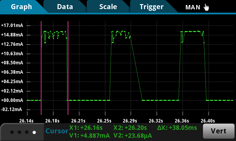

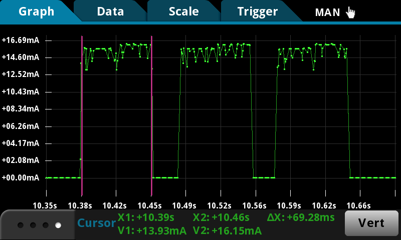

I noticed a difference of ranging time on VL53L4CX in function of target presence or not.
My parameters : AVG = 3 ; DTIM = 33 ms ; INTERMEASUREMENT = 100ms
Current measurements :
  • Without target : pulse width = 38 ms ≈ DTIM
  • With target : pulse width = 69 ms ≈ 2 x DTIM
_legacyfs_online_stmicro_images_0693W00000bkYnvQAE.pngCan you give me an explanation for that please.

The sensor should operate as explained in the user manual (UM2931) page 8 figure 8, one measure (timing budget) per Inter-measurement.
But, when a target is present, the measured timing budget is twice (69ms) the configured value (33ms, measured 38ms). The current consumption of the sensor is therefore twice as high.

this is a tricky one.
When one does a range, there is a possiblilty of something called radar aliasing, or 'wrap around'. It's where a target is beyond the max range of the device and the returning photons get associated with the wrong output flash. If the max range is 4M, a target at 4.3 meters could show up as a target at 0.3 meters.
To detect this, the sensor does 2 sub ranges - call them A and B. Say the max range of the A timeing is 4M and the max range of the B range is 4.2. That target at 4.3 would show up as a target at 0.3 for the A range and 0.1 for the B range. It's enough to know we have an issue and set the Wrap Around status return.
If you are running continously, we can return a result after each sub-range, knowing the prior or next range can do the wrap check.
If you are running Autonomously and there is a gap between ranges, we cannot assume an B range will immediately follow the A range. This means we have to do the A and the B before we return a result.
So when running continously the answer is return at the end of each TimingBudget. When running autonomously the answer is returned after 2X the timing budget.
And that is whay you are seeing.
