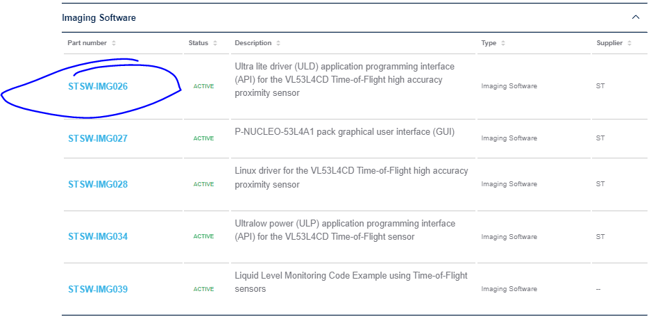

Yes, I can try the normal driver. I think you mean the IMG026, right?
0693W00000WJllZQAT.pngIn case we want to detect this situation where sunligth is higher than normal we could use the

John E KVAM
Exactly correct. As you dig into it you will notice that the ULP adn the ULD are really similar. The ULP is just tuned to integrate for a really short period of time. So short, you really don't get much accuracy.
