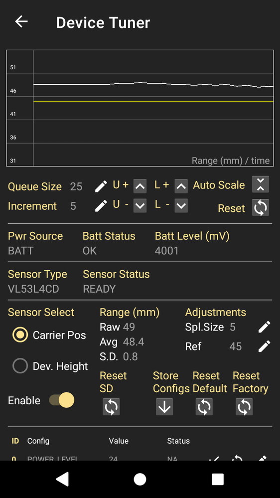

I'm using the VL53LX API 1.2.8 to interface with the VL53L4CD in firmware and I implemented a tuner page in my android app to visualize it.
So far I have this thing ranging pretty well with +/- 1mm accuracy. Not bad!
I'm measuring a permanent grey 3D printed PLA object with a 10x5mm flat face that can move 10-45mm in front of the sensor.
My only issue is that when I start/stop ranging, it starts off on the correct distance (object not moving) and then after ~1min it starts drifting up +2-3mm. However, it tends to cap out there. So, if I'm reading 45 it will climb up to ~48 and settle. If I start/stop again it will repeat.
Is this due to temperature drift or something else? Is there anything to lessen this? I would think that if it was temperature then start/stopping would not cause it to jump back to reading 45mm right off the bat but instead leave off at the last drift value.

The VCSEL does generate heat - and it's effency is affected by that heat. As the temperature rises,there is a VHV (Very High Voltage) calibration that goes on. It will adjust. But it does not have a very fine resolution. So if you warmed the sensor you might see a drift of a few mm, then a snap back as the temp compensation kicks in, then slow drift leaving you with a sort of saw-tooth pattern.
I suppose if you wanted to get the best accuracy, you might find some way to hold the chip at a known temperature.
In fact, if you had a handy way to do this is might be an interesting experiment.
Nicely done on your app. Looks pretty cool.
