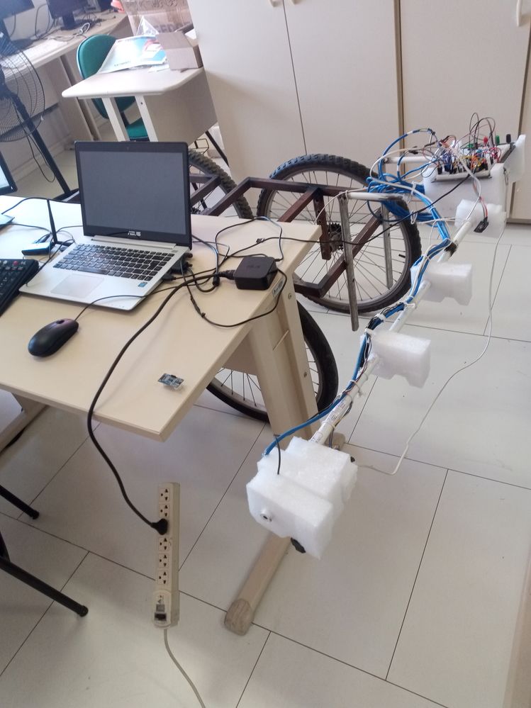

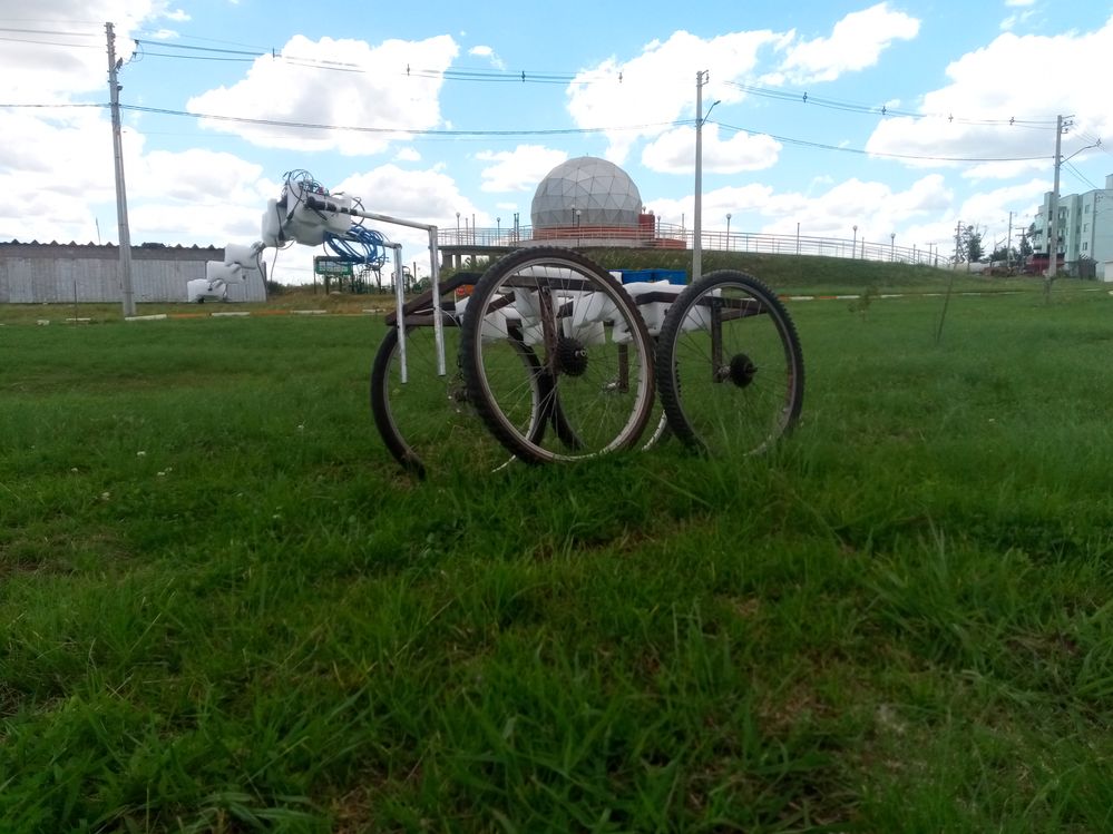

I´m using multiple sensors for distance ( 3 VL53L1X, 1 HC-SR04, 1 TFMini Plus).0693W00000HqZMPQA3.jpg0693W00000HqZhHQAV.jpg

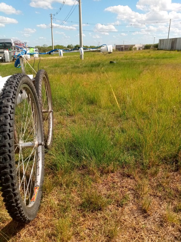

0693W00000HqZiUQAV.jpgI think I need a lot of coverage to shade the measurement point and thus reduce the light to 140 lux (stable in the lab).
I tried to switch to short mode and time budget to 200ms but that didn't solve my problem.
In the laboratory, the TF mini Plus (850nm) did not generate interference on the VL53L1X (940 nm VCSEL).
I ran the experiments for 3 days over several hours, collecting 8622 + 5450 + 1540 measurements, with only 33% useful data from the VLs, 89% from TF and 95 from HC-SR04.
Does anyone have a better idea?

It really is an indoor sensor - or at least a shade sensor.
Is there anyway you can take these measurements at night?
Or supply your own shade?
The sensor would work very well from the underside of a truck.
(Not sure if your wheels are a mock-up of your final vehicle or just part of your test setup.)
There is one New Zealand company building a pasture monitor. But it only ranges at night.

1 - It is desirable that the equipment operate autonomously 24 hours a day, except when it rains or there is dew on the plants.
2 - This week I'm going to run experiments restricting side light that can cause an error on the VL53L1X. A future idea is to use the solar panel shadow over the sensor bar and measurement site.

if you need a solar panel, then just put the sensor under the panel. Unless you get really far above the field I'll bet the panel will shade the sensor enough to make it work. The problem is ambient light. Sunlight has a large component of 940nm and that saturates the sensors photon detector. But pointing the sensor down at surface that is neither very reflective or very mirror-like (non-specular) is good and shading the surrounding area is even better. I'm betting it will work just fine.
