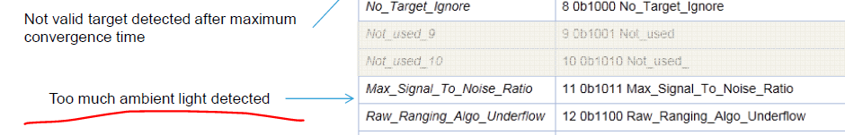

Hi Julien,
Thanks for your answer.
In outdoors condition I am getting the following error while ranging (Max Signal To Noise Ratio), which is due to high ambient light (as stated in API description).
My question is: Is there any setting I can tweak so as to avoid this error and get a range value under these conditions.
Regards, Ramon.
