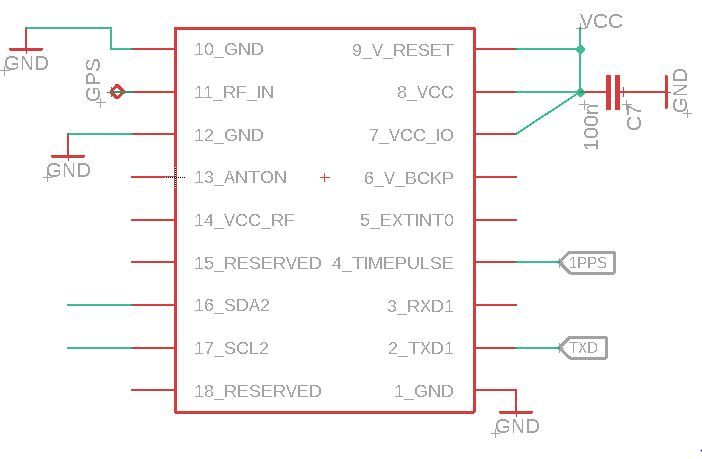

I had recently purchased the TESEO-LIV3F GPS module from Arrow electronics.
https://www.arrow.com/en/products/teseo-liv3f/stmicroelectronics
 I have read the datasheet carefully before purchasing this module and appeared to be very similar to the Ublox Max 7c module. The pin outs were the same and performance and application appeared the same so I ordered ONE to test.
I build small GPS tracking circuits using either Ublox Max7 c or a more generic types such as these -
https://www.aliexpress.com/item/GP-02-GPRS-Series-GPS-BDS-Compass-ATGM336H-Satellite-Positioning-Timing-Module-GP02-PCB-IOT-Artificial/32831293547.html?spm=a2g0s.9042311.0.0.13394c4dFIl0xu
So far,these modules work perfeclty in my circuit but now wondering what is different about the TESEO-LIV3F ?
I am using same voltage ratings (3.3v) in this circuit well within the operating specs.I have 1PPS on time pulse according to my Logic Probe,but not holding the circuit in proper time if at all.I am very frustrated and have been trying many things around the circuit.My circuit designs are always the same identical builds and never had an issue until applying this particular GPS MODULE.So my question is basically...is this TESEO-LIV3F compatible to replace the other GPS modules I have mentioned? If not,can I do something different to get it working properly? Your reply will save me a lot of time if I can find a solution to this issue.

​Hello Jim,
Are you using the same board for all parts you mentioned?
If yes, allow me some comments:
Teseo-Liv3F embeds flash memory and TCXO and support Galileo, Beidou and QZSS.
Teseo-LIV3F doesn't embed LNA and Saw filter you need to add them to increase the sensitivity to -163dBm (intrinsic sensitivity is -158dBm without LNA and SAW filter is needed only in case of coexistence with other RF communication like BT, Wifi, etc ...)
RF input of Teseo-LIV3F is matched to 50ohm (direct connection to antenna).
In case you need to achieve -163dBm, please refer to following link, where you can find datasheet, schematic and BOM as well as the layout rules)
https://www.st.com/content/ccc/resource/technical/document/user_manual/group0/a5/d6/03/c4/b2/26/46/d4/DM00399112/files/DM00399112.pdf/jcr:content/translations/en.DM00399112.pdf
Hope it helps.

I was looking at the datasheet and did see the additional filtering at VCC and suggest I use this for this module.
The other GPS do not require these additional components and must be what is happening here as why it is not working,or not well.
The circuit does use an Si5351 RF chip and first suspected some sort of RFI interacting with the Tesio causing this to malfunction.I have had this occur using Ublox but was resolved by using 1 uf caps on VCC to voltage regulator V+/GND which resolved the issue.Going to dig up some things and try this mthod that you mention as well as in the datasheet.
Thanks for the info.
Just to be clear...we are referring to FIGURE 5 in the manual ?
Jim

Yes I am referring to figure 5 and also figure 12 with schematic.
Best regards
Karim
So looking at my PCB schematic,I do not use this filtering at all. Also...my antenna is simply a 45mm length of wire directly connected to PCB from Pin 11.
Notice I do not have Pin 6 connected...I may also connect that to VCC like figure 12 is showing.
I need to find proper cap/choke values yet. Not sure if I need the additional circuitry for antenna? Looks I will need to reinvent the PCB to use this module.
For only 4 bucks each,maybe easier and wise to just use the Chinese modules I have been using that work fine on my existing PCB. Not saying the Tesio is a bad module,just not feasible for my current design and purpose.Just an FYI... I build and float these small circuits around the earth on balloons which are tracked using a network already in place. But since I already have this module,will see about using it for my test gear in which I can use a GPS for it anyhow.
Thank you for all the help pointing these things out...saved me a lot of time.

VBAT is the supply for the low power domain backup: backup RAM and RTC.
VCC-IO can be connected to VCC easily ( via wire).

Hi
In the module @ https://www.aliexpress.com/item/GP-02-GPRS-Series-GPS-BDS-Compass-ATGM336H-Satellite-Positioning-Timing-Module-GP02-PCB-IOT-Artificial/32831293547.html?spm=a2g0s.9042311.0.0.13394c4dFIl0xu
the pins#7 is declare 'NC' while for Teseo-LIV3F it is the VCC_IO this means 3.3V has to be there to guarantee a correct IO managements.

JZela
When I say RFI this is because the circuit the GPS is mounted to also has an Si5351 chip onboard that sends the RF to be received by radio.In the past,I had issues with 5351 and GPS interfering with each other and learned I needed to isolate this RF using 1uf caps on the power supply to each component...mainly at the regulator which is a SOT23 type 3.3v LDO. Once these caps were installed,everything worked perfectly and have been doing this ever since.However,I am not at all familiar with this GPS module and just a thought,it mat react differently to RFI from the Si5351 chip.Like i mentioned,it was working when first assembled,then when it was sealed and ready to fly,it was tested in real time using solar power and stopped working altogether.Now,disassembled, I am now testing this GPS on a PCB all by itself using FTDI method into U-CENTER software.It started to work and was getting satellites,but no FIX...now ,I do not even get that much from it.It may now be damaged after all the soldering / desoldering. No big deal...I have bought replacements and will mess around with it after I get the main project finished.Like I said,this was a test run GPS since it was readily available from Arrow which ships free over night and was convenient for me as back up.I was hoping this module was like the others and drop in,solder and done...not the case.
