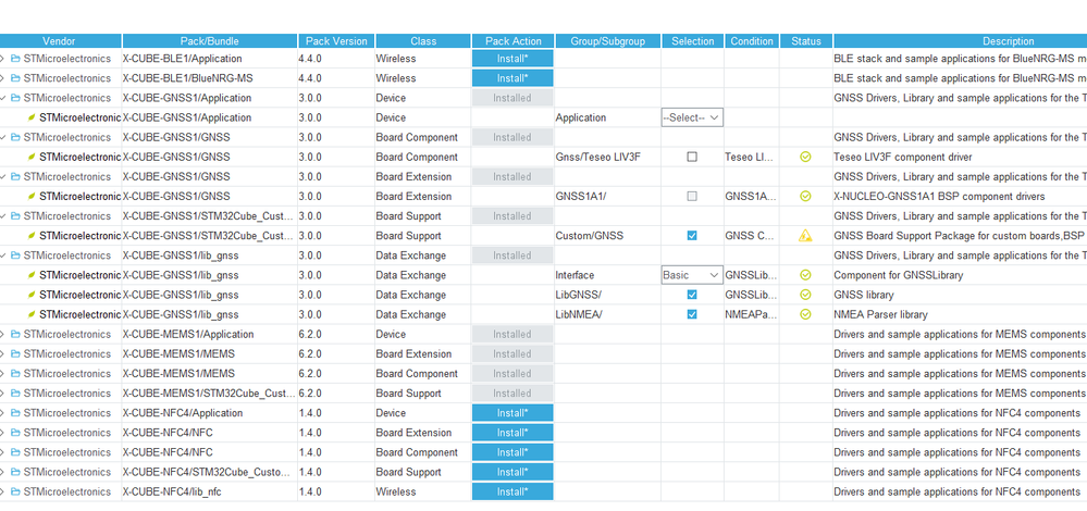

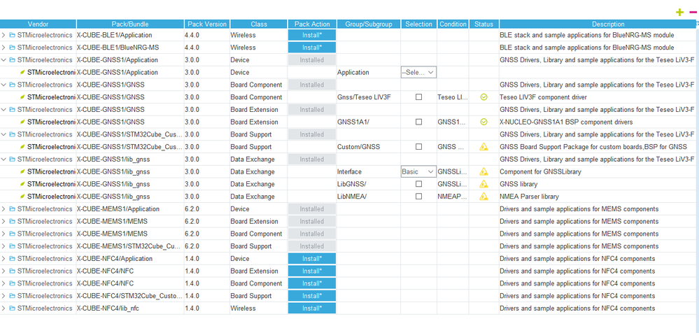

What Options do I need to check on CubeMx if I only want the driver, the gnss library and the parser to do just basic stuff and start from scratch?
JOrta
I am confused on what to add just to have the minimal function to read from the serial port the messages..0690X000009YNMiQAO.png
I am choosing this...

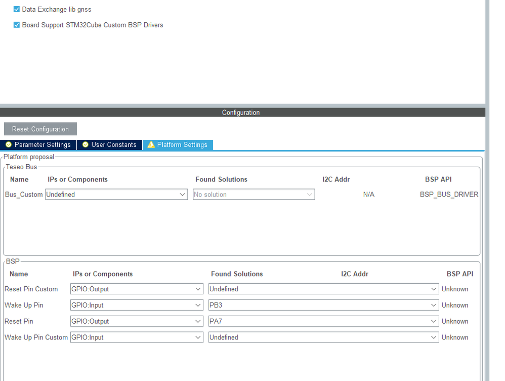

but i get duplicated pins.. not sure why

​Hi,
to just enable the Driver and the Parser lib, you should check the "Board Extension" and the "Data Exchange" (Basic Interface, LibGNSS, LibNMEA) boxes.
Kind regards
