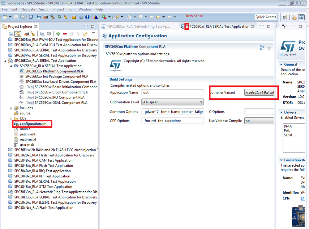

I use the SPC5 Studio 5.6 to open an old project and get the following error.

Hello Zhang ,
-mcpu=e200zx is for hightec compiler
-mcpu=e200z0 (or e200z4) shoudl be for the free compiler.
I think that you should use the free compiler.
Do you use SPC5Studio components ?
If yes , your configuration.xml is in ''dirty'' state, go back to your platform component choose , Save and regenerate
  Best regards
             Erwan

So pick the e200z part most closely matching what you're building for, likely a newer version of compiler handling more variants. Or go dig up an older version of compiler contemporaneous with the project.
