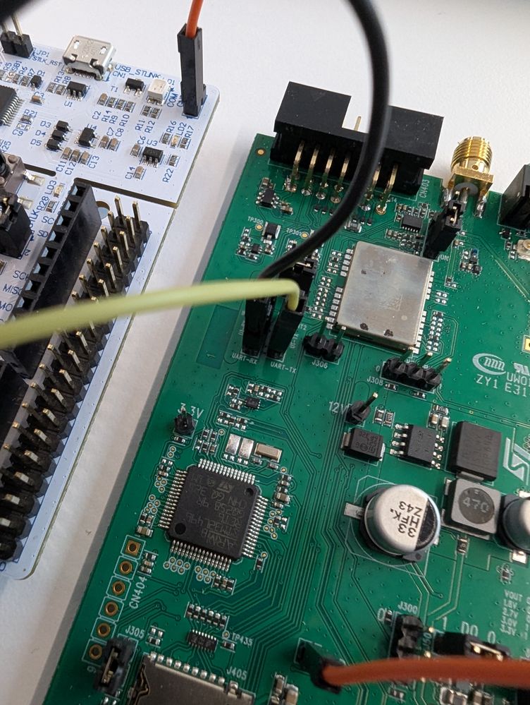

I am currently trying to get the nmea sentences from the above gnss module (vic3da) i have connected the uart rx/tx and ground (gnd) and am able to ping the gps unit but unable to read any data from it has anyone ever written code that i might have a look at to know if I'm doing some thing wrong as I am completely new to MCUs or can anyone guide me to complete my project successfully ?

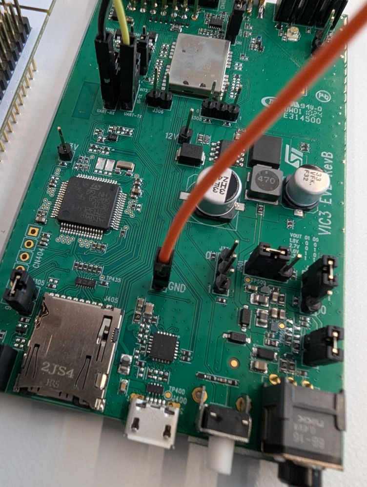

GalaxyQuest
VIC3DA has 2 UARTs, UART1 and UART2. By default, NMEA is coming out of UART2.
Can you please tell me which UART (UART1 or UART2) you are tapping into?
Where you are connecting the UART lines?
Have you put a scope or logic analyzer on the UART TX pin to see if there is data coming out on the point where you are tapping into?

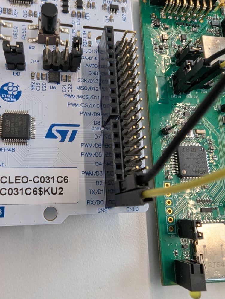

swayamsidhmohanty
pin layout ioc filepin layout ioc filetx/d1 rx/d0 on the boardtx/d1 rx/d0 on the boardtx/rx on the gnss moduletx/rx on the gnss modulegndgndgndgndall wire connections between the boardsall wire connections between the boards

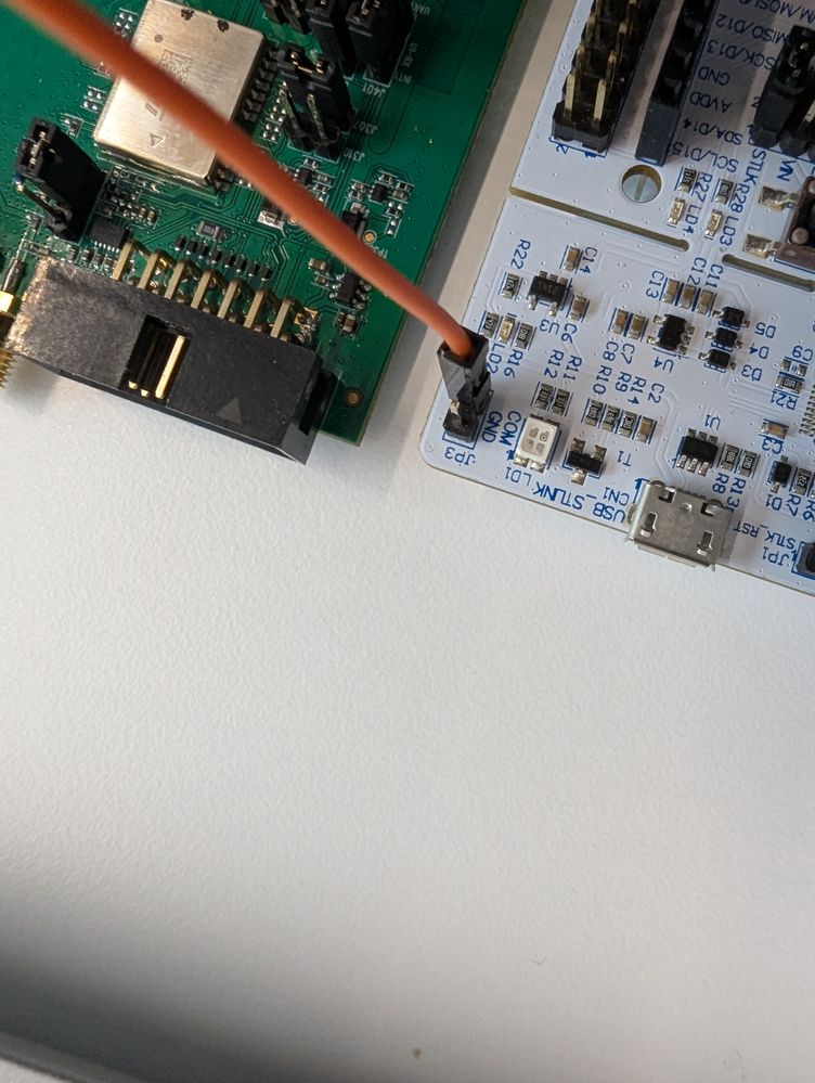

Isn't there a pin level conflict on the NUCLEO-64 with Arduino rail D0/D1 and ST-LINK VCP?
Why echoing NMEA back to receiver?
Hi !
I'm completely new to this so .. Did you mean to use two different UARTs?
UART2 for the VCP (USB) and UART1 for the communication between the gnss module and the mcu ?
Looking at the Schematic  https://www.st.com/resource/en/schematic_pack/mb1717-c031c6-b02_schematic.pdf#page=3
PA2/PA3 (USART2) is for the ST-LINK VCP, can connect to rail via SB (Solder Bridges)
PB6/PB7 (USART1) is for the Arduino rail
Pins for MCU via Data Sheet tables
https://www.st.com/resource/en/datasheet/stm32c031c4.pdf#page=36
So interact with the VIC3DA via the STM32C031's USART1, and echo/diagnose through USART2 to the ST-LINK and the terminal connected to that COM/VCP
Hi
I have tried to run the program as per the suggested configuration. Still i am not able to communicate between the gnss module and the MCU.
I have also some confusions in the initialization of the GNSS. I dont know what all parameters needs to be initialized. I have only tried with the baud rate. Please guide me.
Start by doing this without the MCU - that's just an unnecessary added complication.
Connect that GNSS board to a PC terminal (via UART-to-USB converter).
In particular, pay attention to line endings - does it need just CR? just LF? CR and LF?
Once you've got that working, then (and only then) start thinking about how to implement that on the MCU.
Similarly, get your MCU UART code working with a PC terminal before connecting to the GNSS
swayamsidhmohanty
Hi
I have tried connecting directly using USB to PC and the values are coming in serial monitor. But not in MCU.
