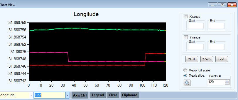

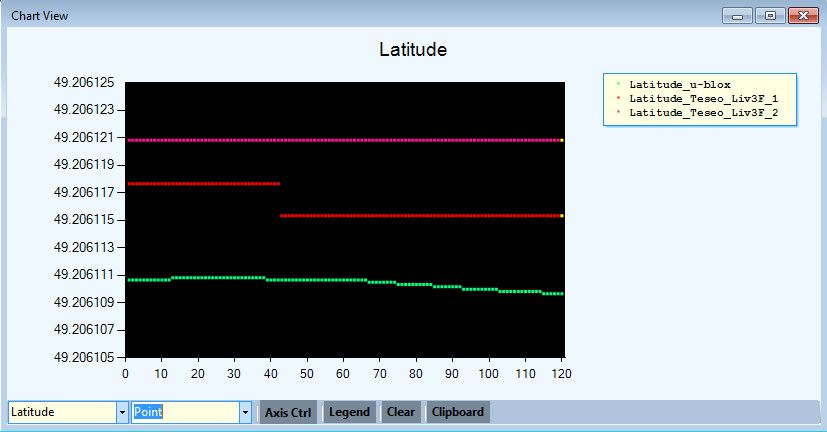

Hi! Why are the coordinates (latitude and longitude) of the Teseo-LIV3F changing abruptly and not smoothly like the u-blox M8 and NV08? Smooth change of coordinates is very important to me, since the direction angle is calculated in our program precisely
10 REPLIES 10
Did you turn off the Stop detection algorithm? Turned on the walking mode, Stop detection turned off the algorithm, the result is better, but nevertheless there are jumps, but less often. I want to say, we use your receiver on a vehicle, the speed is up to 30 km \ h. This is agricultural machinery.
