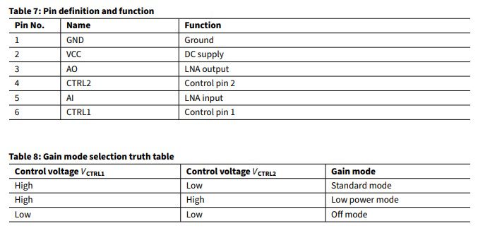

You are using a LNA (BGA535N6?), according to the data sheet, You have to connect the CTRL1 and CTRL2 input's.
Further more the data sheet suggests a serial inductor on the input side (for impedance maching).
Probably You could ask Taoglas for help on the impedance maching for the antenna.
The Bandpass filter used (B39162B4327P810?) seams to be only for the L1 Band, the LIV4F is a dual band receiver so You should use a dualband Bandpass filter. But this should give You anyway all the L1 band signals, so not the main problem at the monent.

‎2025-04-09 12:12 PM
Please consult the datasheet for Your LNA, if it is the BGA535N6 (the schema is blurry) then:
‎2025-04-09 12:14 PM
Yes the LNA is BGA535N6, got the issue and solutions.
