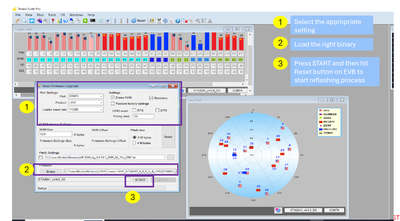

Hi Jake,
When programming with Teseo Suite in Windows, can you please make sure Erase NVM and Recovery are checked.
Attaching screenshot below. Please let me know if that works
JCharette
I tried as you suggested, double checking that my screen matched your screenshot, but am still facing the same "CRC Error" at the end of the update process.
