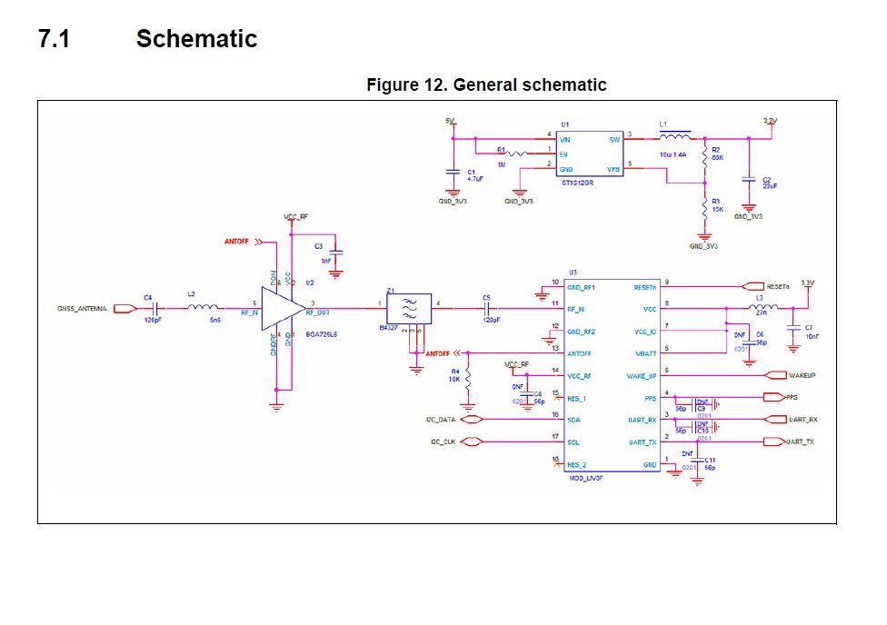

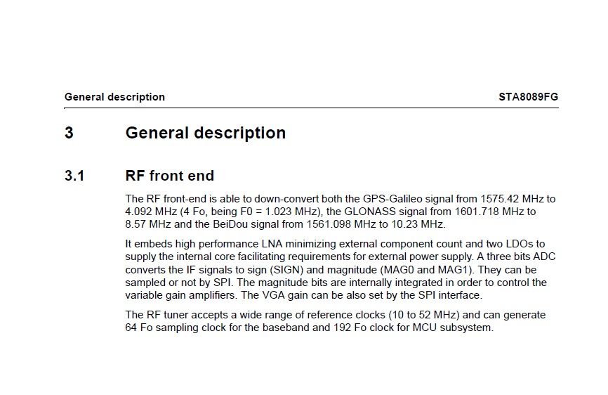

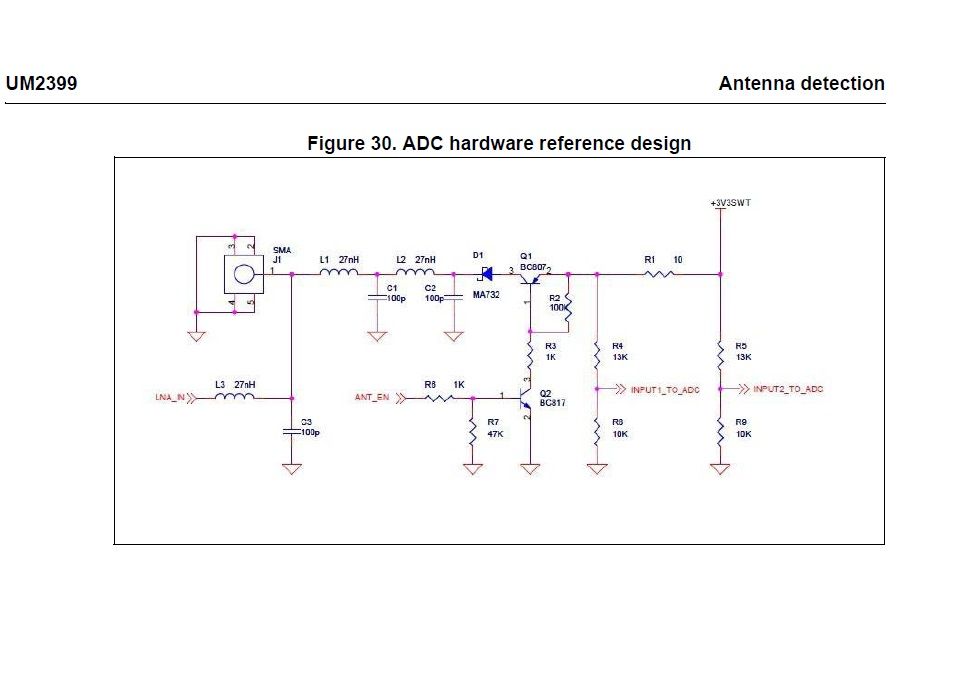

Hi, I have read about the shield and certification and I understand that, but as I mentioned before both needs external components, so the unique difference would be the certification right?, the 7.1 schematic is a photo from the TESEO module hardware manual, even it seems that TESEO needs more external components than the STA8089 (figure 30), because it mentions that you need an external SAW filter and LNA, and the STA8089 has internal LNA and does not mention any time that a SAW is needed, just needs a few components for the antenna detection, or maybe am I wrong?, thanks
