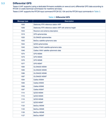

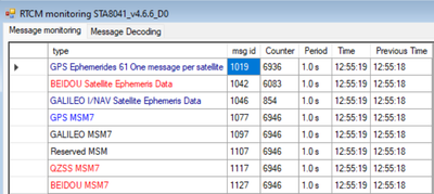

I updated the firmware to the ME version, I am receiving some RTCM messages, but only a limited amount shows up in the message monitoring, also nothing can be decoded. Is there any documentation available on how to configure which RTCM messages should show up. I want to experiment with RTK calculations, so if there is any material on how to access and decode these RTCM messages would be highly appreciated.

I have the definitions, but the LIV4F only publishing a limited amount of them. My question is on how to configure the firmware to publish the rest.
Which do you actually need? A single MSMx for a given constellation, you don't need 4 thru 7, or whatever. They are different ways of expressing the same data, the 7's having the most precise data, the packets a little larger.
The table is for the "INPUTS" supported.

1107 is SBAS MSM7

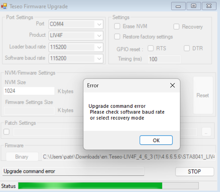

The module suddenly stopped working and does not send any data, also no SW is possible, I tried different baud rates, recovery and factory settings as well, nothing happens.
Hi Patrik,
While reprogramming, please check the boxes, Erase NVM and Recovery.

The RTCM strings we output are the essential ones to get RTK fix.
