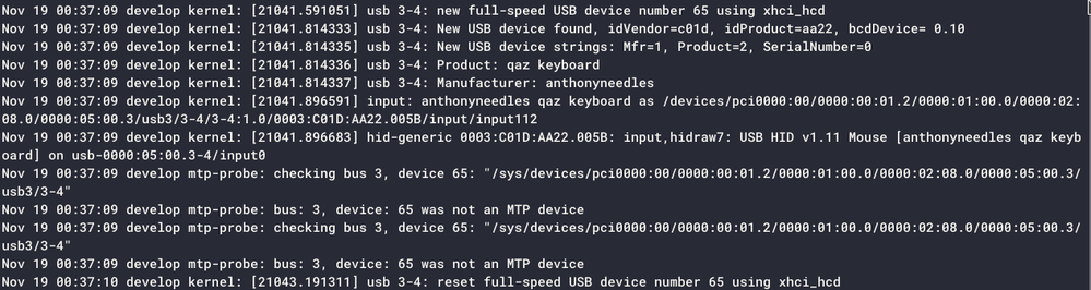

The project is a keyboard, but for now I've defined the device as a mouse HID device in the Interface descriptor. I've been able to successfully transmit all requested descriptors, set the given address, etc. Right at the end of HID enumeration the host sends a Get Descriptor request for the Report descriptor, and an HID-specific request of SET_IDLE. I'm getting both of these, and am expecting the host to start sending Get Report requests to EP0, at which point I would send the report from EP1 - Interrupt IN (or NAK if there is no change in data). But instead of a Get Report, the host immediately resets the device, enumerates again then resets, and so on.
I'm doing the testing on a Debian machine. This is the output of `tail -f /var/log/syslog`:
As you can see, the host gets the string descriptors, and identifies the device as an HID Mouse device. But I resets right at the end (I'm almost positive the mtp-probe stuff has no effect).

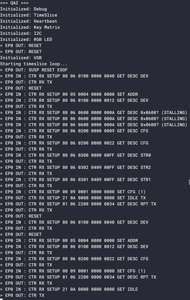

Here is the output from the serial debug output:
0693W000005C0baQAC.pngThe format of the printouts is:
  • `>` - the start of a USB interrupt
  • `EPn` - the EP that the interrupt is related to
  • `IN`/`OUT` - direction of successful EP transaction (`OUT` can also mean both TX/RX)
  • The next bit shows the reason for the interrupt, usually `CTR` (correct transfer) or `RESET`
  • In the case of a `CTR`, `RX` indicates the EP had a correct `OUT`/`SETUP`transaction, and `TX` an`IN` transaction.
  • Then `SETUP` if the transaction was a `SETUP`. The string of numbers is the contents of the `SETUP` request. Then, the description of the request (Get Descriptor, Set Address, etc.), followed by the descriptor in the case of Get Descriptor.
We can see the device proceed through enumeration, get to the Get Descriptor, Report request then immediately `RESET`.
