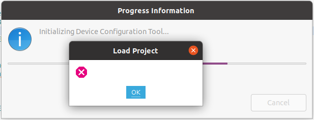

It's even worse! Now I cannot simply open an .ioc file anymore! (PC only.)
I've encountered the same error while opening this .ioc file (https://github.com/dizcza/stm32f446-FunduMoto/blob/nn/stm32f446-FunduMoto.ioc) in both CubeIDE CubeMX perspective and the latest STM32CubeMX 6.2.1 (standalone).
