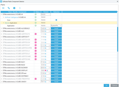

First, please install the version 10.0.0 of CubeAI as it integrates bug fixes of previous versions (always uses the last version).
Then here is what I suggest doing:
  1. Open STM32CubeMX and select your board with the board selector
  2. Initialize peripherals by default
  3. Activate X Cube AI 10.0.0 and select either the validation, system performance or application template.
Basically, if you only want to validate your model on target (compare how the model behaves on your target), use the validation template.

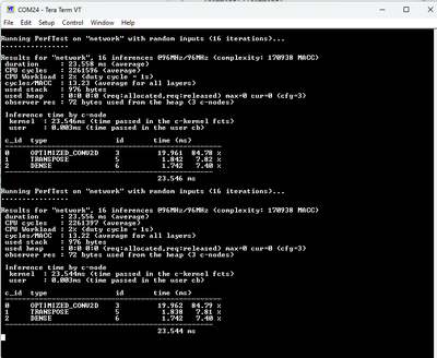

If you want an example of running application that compute the inference time of a random input and send via serial some metrics, uses the system performance template
If you want a template where the AI_run function is already in place, but you have to edit the input and output function, select the application template.
Here I will take the system performance template:
  • Then, click No when asked to automatically fix clock and peripherals for better performance, I believe, sometimes it can create issues.
  • Then browse for your model
  • Click on analyse to at least make sure that your model is compatible
  • Generate the code with your toolchain/IDE
  • Open STM32CubeIDE -> Build -> Flash
  • Open tera term to see if you get the output
