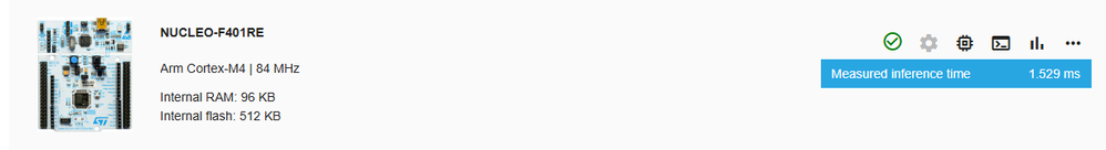

Error output when trying to quantize CNN2d_ST_HandPosture_8classes_hand_posture_ST_VL53L8CX_handposture_dataset.h5 in STM Edge AI Developer Cloud. For example, the error "Could not find cuda drivers on your machine, GPU will not be used." Why do I need cuda drivers on my machine when I am running in the cloud? If anyone knows the cause of this error, please let us know.
Julian E.
Hello @Shion,
The "Could not find cuda drivers on your machine, GPU will not be used." is just a warning, it is not the blocking point here. As you say, you don't need to install cuda on your pc.
The model is quite small even unquantized.

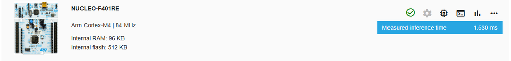

In terms of inference time, it is the same:
Not quantized:
Quantized (with above script):
In term of accuracy, it needs to be tested, I think that if model zoo does not quantize it, it may indicate that you should not do it. But you can try (in the example script, it is quantized with random data. Quantizing it with real data is Highly recommended).
