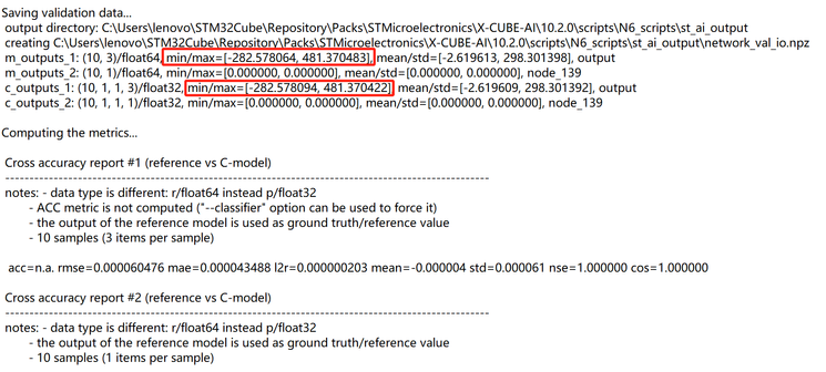

I have validate on the STM32N6 board by onnx model in STM32MX,but i have two different output ,like this:
 m_outputs_1: (10, 3)/float64, min/max=[-282.578064, 481.370483], mean/std=[-2.619613, 298.301398], output  m_outputs_2: (10, 1)/float64, min/max=[0.000000, 0.000000], mean/std=[0.000000, 0.000000], node_139  c_outputs_1: (10, 1, 1, 3)/float32, min/max=[-4.547175, 5.813805], mean/std=[0.008044, 4.321293], output  c_outputs_2: (10, 1, 1, 1)/float32, min/max=[0.000800, 0.000800], mean/std=[0.000800, 0.000000], node_139
the  m_outputs_1 is error, and c_outputs_1 is correct,why? what can lead to this problem?
please help me ,thanks very much!!!
I have upload the report.txt and onnx model in the attach.

and  get the same two results by  Julian E.'s five steps,like this:
By this way,I think I have validate on target successfully.

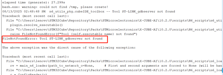

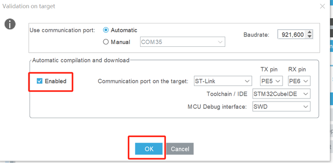

But when I go to STM32CubeMx,and click the validate on target,and check the Enabled,I still get the previous issues ,like this:
when I get the previous issues, I found that the config.json has been modified to like this:
  "gdb_server_path": "E:/ST/STM32CubeIDE_1.18.1/STM32CubeIDE/plugins/com.st.stm32cube.ide.mcu.externaltools.stlink-gdb-server.win32_2.2.100.202501151542/tools/bin/",
    "gcc_binary_path": "E:/ST/STM32CubeIDE_1.18.1/STM32CubeIDE/plugins/com.st.stm32cube.ide.mcu.externaltools.gnu-tools-for-stm32.13.3.rel1.win32_1.0.0.202411081344/tools/bin/",
    "objcopy_binary_path": "E:/ST/STM32CubeIDE_1.18.1/STM32CubeIDE/plugins/com.st.stm32cube.ide.mcu.externaltools.gnu-tools-for-stm32.13.3.rel1.win32_1.0.0.202411081344/tools/bin/arm-none-eabi-objcopy.exe",
    "cubeide_path": "",
    "compiler_type": "gcc",
    "cubeProgrammerCLI_binary_path": "E:/Program Files/STMicroelectronics/STM32Cube/STM32CubeProgrammer/bin/STM32_Programmer_CLI.exe",
    "iar_binary_path": ""
 As I have validate on target successfully by the first way(above-mentioned),
why it can generate this problem by use STM32CubeMX?
Is there any differences between two way?
Thanks!!!

Hello
I'm not sure to fully understand, but there is definitely a problem with your last config.json: setting "cubeide_path" to "" is not similar to fully removing the line (in the way the config file is parsed).
Setting it to "", indicates to the tool that you expect to find cubeide in your current directory, then when trying to find gdb_server in your current directory, everything fails.
So, if this is x-cube-ai who erased your config.json, then this is problematic :), but the main thing is that you now know how to perform a validation on target after editing your config file.

  1:go to stm32cubeMX,click the validate on target,and check the enabled,the click ok like this
The results is that I validate on target successfully by the first method,but get a problem by the second method.
I think the reason is that  config.json has been modified to  "cubeide_path""".but i do not know what lead to this
phenomenon?
Thanks!
SlothGrill
Hello
Agreed, it's a bug on X-Cube-AI, then, as setting the path to "" will most likely lead to buggy flow.
I guess X-Cube-AI checks if cubeide has been installed on "standard" paths (i.e. not E:), and fallback to setting the config to "" when not found.
We will post a bug for that.
Thanks.
Hi @SlothGrill when I can get the latest X-Cube-AI which can solve this bug? As i want to validate on target by STM32CubeMX. Thanks very much!!!
SlothGrill
X-Cube-AI gets updated when new versions of STEdgeAI are released. So there will be no available versions with a fix before any new STEdgeAI release (i.e. do not expect anything before some months...).
For now, if you really want to use X-Cube-AI, you can try to reinstall CubeIDE properly and see if it fixes the issues (eventually removing the old versions that may lie around on your PC may help). Or try to install it on standard target directories (eg. c:\ST\...)
Best regards.
