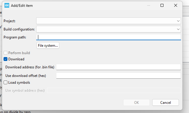

Hi @Julian E.
Can i do the same from cube IDE? if so, please let me know the steps for flash the 3 .hex. Alo can i flash .elf?

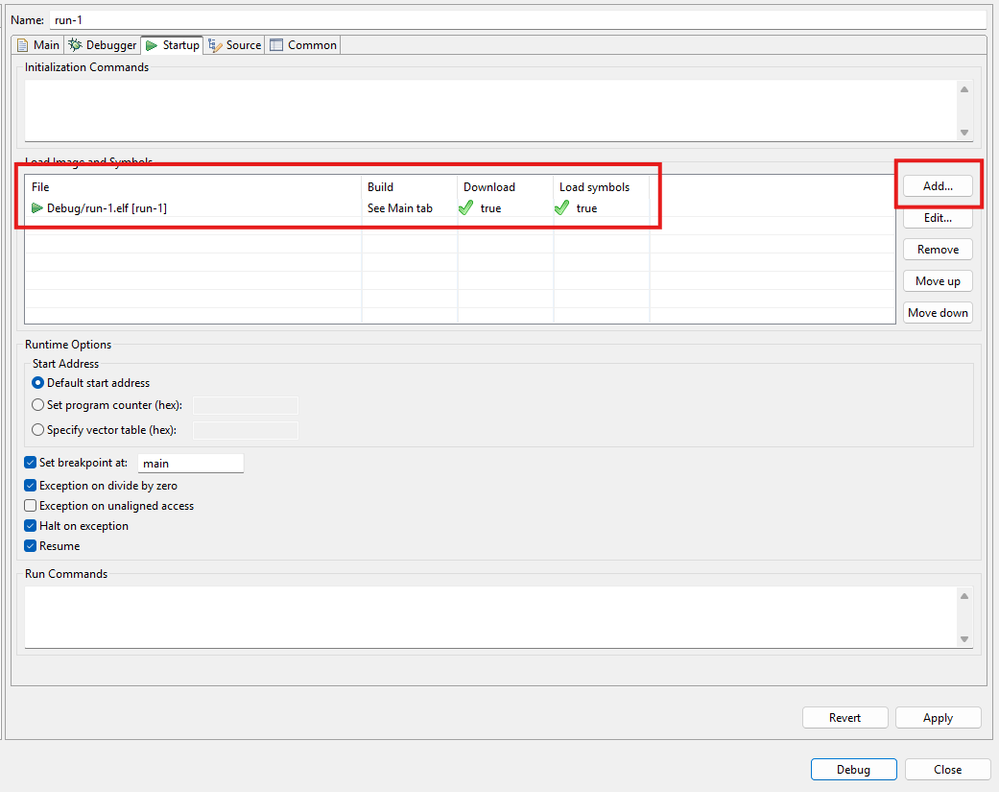

hamitiya
To complete what shared Julian:
From STM32CubeIDE, you have the ability to load .elf as well as .hex files during your debug startup:
If flashing .bin, you will need to provide the address where you want to load your content. For .hex and .elf file, start address is already in the file
This content will be loaded through the debugger.
