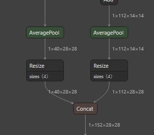

I am trying to convert my Onnx model with the ST Edge AI Core tool to the .nb format for the STM32MP25 target.
While converting the model i get the following error:
ST Edge AI Core v2.2.0-20266
INTERNAL ERROR: unsupported operand type(s) for *: 'int' and 'shape_struct'
I could track down the error to a resize operation in the Onnx model. Here is a short snippet how the model looks like:
When i remove the resize operations and downscale the 28 x 28 patches to 14 x 14 patches. Then the error is gone.
So i think that the resize operation is the problem.
This happens for quantized and non quantized models.
Like stated here (STM32MP2 NPU description - stm32mpu), there should be some resize operations implemented at least on the GPU.
Did anyone had similar issues and know how to fix them?

Sure, i have attatched the model files. It's basically an MobilenetV2 but for the outputs i am using the blocks 2 and 4. I wanted to resize those patches to a common size and concat them.

We confirmed the bug. This comes from the NPU.
We opened a ticket at Verisilicon, our NPU supplier.
I'll update you if we get an answer.
