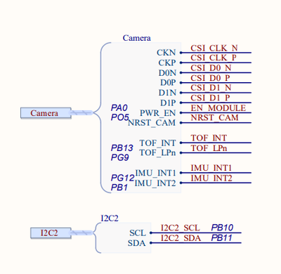

Saeid
Hi @VABRI
I am working on connecting RPi 2 IMX219 to STM32N6 Nucleo board and I am new to Camera topic.
Do I need to configure CSI or DCMI or DCMIPP peripheral  ?  I got confused as schematic of Nucleo board has CSI labels.
