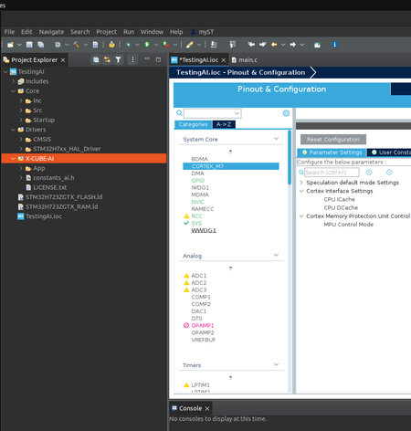

2024-01-16 6:53 AM
I don't have `TMPAILIB`. Here is what I have.
Also, Notice that the `.ioc` is show as not saved. I did save it.
What happens is: After I save it, the options to regenerate code appear, then I click o regenerate, then after regeneration is done, the `*` is shown again in the `.ioc` tab as if I had changed the file. Then, if I try to close it, it will ask me again if I want to regenerate. Then, the loop continues.

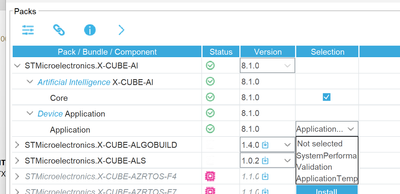

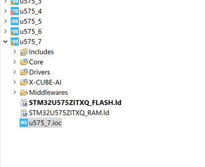

2024-03-15 10:51 AM
I encountered the same issue and was able to resolve it by selecting "Add necessary library files as referenced in the toolchain project configuration file" in the Project Manager in addition to unchecking "Delete previously generated files when not re-generated".
This was on Ubuntu 22.04 with STM32CubeIDE Version: 1.14.0 and X-CUBE-AI version 8.1.0

2024-05-30 3:54 AM
Hi, you probably don't need the answer anymore, but I found out that the middleware files are correctly generated and included if you select the application template while including the cube-ai.
So for anyone who is trying to work with versions post 5.0.0, this is how you fix your middlewares problem.
