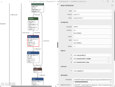

Hello @sandeepchawla74,
Sorry for the late answer.
We found that your issue is a bug due to a shape computed wrongly.
In your model, seemingly starting at the conv2d_12, the output that should be of shape (1x512x8x8) is seen by the st edge ai core as (1x512x18x18) which cause the  concat below to try concatenating a shape (1x512x18x18 with 1x512x8x8 (right arrow)) which does not pass.
The issue seems triggered by the dilatation and the lack of an attribute "kernel_shape" not specified which is legal in ONNX.
By editing the model and adding the "kernel_shape" to every conv2d, it solves the issue.
It also save the model using ONNX ir version 9 as the version 10 is not supported by the core.
