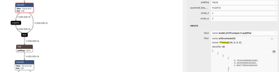

I porting yolov11 model to stm32mp257. and The target detection model I use ,The output tensor is a combination of [1x7x8400] and [1x4x8400]. [1x7x8400] should be our classification because I have set 7 categories, and [1x4x8400] should be our positional information.
1. best.pt changed to best.onnx
from ultralytics import YOLO
# Load the YOLO11 model
model = YOLO("best.pt")
# Export the model to ONNX format
model.export(format="onnx") # creates 'yolo11n.onnx'
2. best.onnx changed to best.nb
./stedgeai generate -m path/to/onnx/model --target stm32mp25
3. into broad stm32mp257 ,and get output shape.

4. I received the following output.I use the onnx model, and the probability of all 7 categories on the PC is 0. This seems to be correct, and the reasoning is also correct. However, when converted to. nb format, why is the probability of all 7 categories 1? This is obviously not correct. Why is this?

Hi @fanronghua0123456,
using the saved_model.pb and this quantize script:
import tensorflow as tf
import numpy as np
def representative_dataset():
    for _ in range(10):
      data = np.random.rand(1, 640, 640, 3)
      yield [data.astype(np.float32)]
# Convert the model
converter = tf.lite.TFLiteConverter.from_saved_model("./saved_model")
converter.optimizations = [tf.lite.Optimize.DEFAULT]
converter.target_spec.supported_ops = [tf.lite.OpsSet.TFLITE_BUILTINS_INT8]
converter.inference_input_type = tf.uint8  # or tf.int8
converter.inference_output_type = tf.float32  # or tf.int8
converter.representative_dataset = representative_dataset
converter._experimental_disable_per_channel = True
tflite_model = converter.convert()
# Save the model
with open("model.tflite", 'wb') as f:
    f.write(tflite_model)
then passing the edge ai -> model.nb
and testing on the board with this script:
from stai_mpu import stai_mpu_network

we get this:
Loading dynamically: /usr/lib/libstai_mpu_ovx.so.6
[OVX]: Loading nbg model
**Input node: 0 -Input_name: -Input_dims:4 - input_type:uint8 -Input_shape:(1, 640, 640, 3)
**Output node: 0 -Output_name: -Output_dims:3 -  Output_type:float16 -Output_shape:(1, 11, 8400)
640
640
----1
Dtype after resize:  uint8
Shape after resize:  (1, 640, 640, 3)
----1test
----2test
----2
Inference time:  118.66035591810942 ms
output shape:  (8400, 11)
confidence shape:  (8400, 7)
[0.75878906 0.01785278 0.54003906 0.         0.         0.0044632

Hello @fanronghua0123456,
When you export the model, you get multiple ones.
It seems that this one: best_int8.tflite is not fully quantized.
In particular, the conv3 is not quantized:
explaining the error you get:
PASS: 0%| | 0/2 [00:00<?, ?it/s]E [ops/vsi_nn_op_conv2d.c:op_check:189]Inputs/Outputs data type not support: FLOAT16, SYMM PC INT8
You need to use this one: yolo11n_integer_quant.tflite
This should work, but,by default, ultralytics exports the model quantized in per channel, which is not optimal for MP2. You will get an inference time of around 400ms.
║     X-LINUX-AI unified NN model benchmark      ║
║           Machine           ║  STM32MP257F-DK  ║
║          CPU cores          ║        2         ║

fanronghua0123456
Hello. @Julian E.
Thank you very much for your reply. I followed your plan。
1.Increase parameters
quant_type="per-tensor",
2.used _integer_quant.tflite file.
******_integer_quant.tflite
, and it really works. I have attached the picture for your reference.
 but when I call it using C  stai_mpu_wrapper library , and i want to output my shape.
