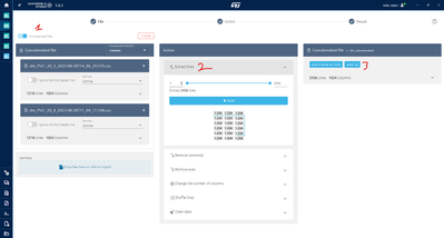

For now, because you are doing anomaly detection, I would suggest you using the Data Manipulation tool to merge the files into 2 files: Nominal and Abnormal (you can do more, but not 533). To do so:
  1. Import all your nominal files
  2. Click concatenate
  3. click extract lines
  4. click save as
Then do the same with Abnormal data.
