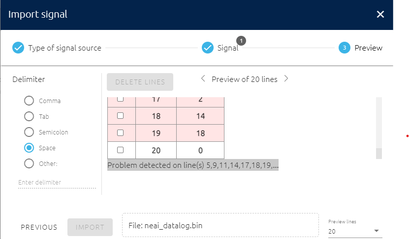

3. Regular Signals: Add signal-> From File -> Choose the neai_datalog.bin which is generated in STEP#2 -> continue but with followed capture's error: problem detected on line(s) 5.6.7.8,xxx.data.png
Could you please guide how to go to next step for benchmark?

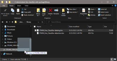

The binary file is to be flashed on your F401RE to be able to log data from serial. Here you tried to import code for microcontroller as an input file containing data.
You can find a tutorial here where everything is explained: https://wiki.st.com/stm32mcu/wiki/AI:How_to_create_a_multi-state_vibrations_classifier_using_NanoEdge_AI_studio
Basically, the steps are:

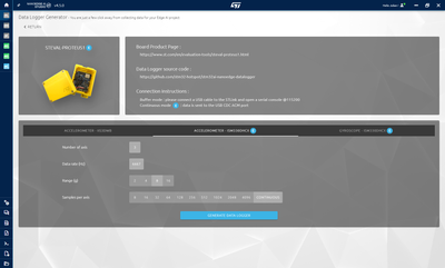

  • Generate a datalogger to be able to collect data via Serial (usb) from your board:
(example with a STPROTEUS)
  • Flash the generated binary

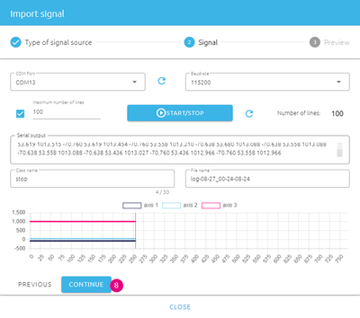

  • Go to the Signals steps
  • Select "From Serial (usb)"
  • Select the right COM Port"
  • Collect data

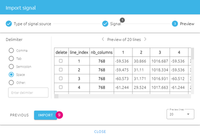

  • Load the data
