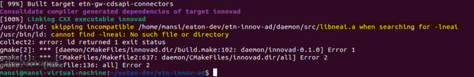

Hi Sam,

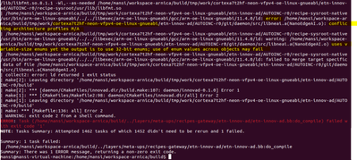

After integrating neai lib with my C++ project, I am getting the below incompatible error when I build my project locally on my Ubuntu VM.
Due to the error I skipped the local build and went ahead to build my neai integrated Yocto based project on STM32MP1 target with Linux .
I need some help to understand the cause of the incompatibility build error on my VM and confirm if neai library can run on my STM32MP1 target with Yocto based C++ firmware and Linux.
Thanks in advance!

Hello Mansi,
The incompatibility issue could have multiple causes.
Can you please check if the float ABI settings are matching ?
And activate the verbose mode in Yocto, and provide me with the linker log files ?
Thanks,
Sam

Hi Sam,
Thank you for the prompt response.
I am attaching the screenshot of error linker logs for Cortex A7 (STM32MP1) target and warning related to floatABI and architecture.
While exporting the neai library I have selected hard-float ABI and checked fshort nums which gives below output.
Thanks,
Mansi

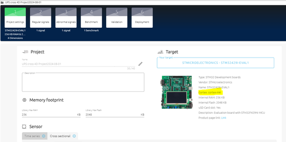

2024-08-14 7:36 AM - edited 2024-08-14 7:43 AM
Hi Sam,
Adding to the above message, as my target is an STM32MP1 (Cortex A7 + Cortex M4) and my NEAI project was created for cortex - M4 as STM32MP1 target was not available but I intend to deploy it on Cortex A7 because -
I could see a solution to my problem could be to create NEAI project for Cortex A7 as a target but unfortunately it seems that NanoEdge AI doesn't have support for Cortex A7 in target selection.
Can you please advise the way around for my case?
