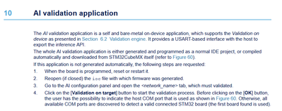

This makes sense to me, because in the documentation that you sent here
https://stedgeai-dc.st.com/assets/embedded-docs/stneuralart_getting_started.html#ref_getting_started_evaluate
It says to look at the CLI documentation here
https://stedgeai-dc.st.com/assets/embedded-docs/command_line_interface.html#ref_validation_on_target_overview
That directs to here
https://stedgeai-dc.st.com/assets/embedded-docs/stm32_on_target_validation.html
That directs to the file; Phew... a lot of redirecting :)
https://www.st.com/resource/en/user_manual/dm00570145.pdf
Where it shows this -
And I am wondering if such validation application already exists or I need to create one myself from the bottom up using your (Awesome) tutorial here that implements what you said -
