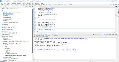

Initially I was having issues in generating the project file for ai models because of CUBE AI withe the latest update it got fixed. But while trying to build an flash the code to the Board there was issue while flashing the code the debugger was giving output as target is not responding. for checking there was no issue with the connection or debugger I tried creating a sample example from CUBE MX and while running that one it was working fine.
I have given below the screen shot of the error that i was getting.
